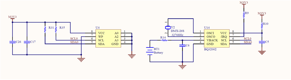

Hi Team,
Good wishes to you!  I'm working with the MSP430F5522 on my custom board. I need to read RTC time from the microcontroller (using I2C) to check if the time data is working properly or not. I'm using an external RTC, BQ32002.
I have successfully written and read. but I have problems during reading/seting time.
Problem is, I set a time like 85, 88, 35, 1, 49, 18, 35; // 31/12/2023 23:58:55
But each time, I got wrong date data such as:
in debug mode, the read data is as "0x7A, 0x25, 0x77, 0x07, 0x3C, 0xFF".
it seems BQ32002 doesn't work at the normal state.
Here is my code (with silght change for BQ32002) from MSP5522 code library: https://dev.ti.com/tirex/explore/node?node=A__AKT9feld19D8QYxvBMQtww__msp430ware__IOGqZri__LATEST
MSP430F55xx_usci_i2c_standard_master.c

Hardware schematic for BQ32002 is as follows:
Please tell me how to solve it and what changes I would make.

    On the hardware side, is there pull up resistors on the SDA and SCL line. I could not see it in those pictures.
    About the software, do you mean your receive message from BQ32002 is not correct? Have you use a logic analyzer to capture the signal on the I2C bus and check if it is correct on the bus?
    Cash Hao
  • Hi Cash,
    Thanks for your reply. More infos, There're two I2C devices on this same I2C bus, where you can find the previous I2C device has also pull up resistors as follows:
    the previous I2C device can be operated normally, and I2c operation read/write on this device is okay.  The problem is the I2C read/write on BQ32002, I couldn't identify these receive message from BQ32002 is right or not, it seems the value(times, such as seconds/minutes/hours/month/yeah) hasn't been set to BQ32002 the correct value as the code.
    Banbom.
  • The most striking thing about the read-back data is that each should be (at least in the low-order digit) BCD, and only 3 of the 7 are. The data sheet claims that, even supposing it were written wrong, invalid data will be repaired (it doesn't say how exactly) over time.
    A couple of quick experiments:
    1) Before you do any of the fixups, just read all 10 registers and see if they look anything like the datasheet says.
    2) Extend your loop delay from 0.25 sec -> 1 second; during this time the SECONDS register should have been "repaired" (somehow).
    What is the other device on the bus? It reminds one of an EEPROM/FRAM; those are usually address 0x5X rather than 0x6X, but I'm trying not to assume anything.

  • Hi Banbom,
    Do you have a logic analyzer to capture the data on the I2C bus? Can you compare it with the readings in the MCU and check if they match each other?
    Cash Hao
  • This data is not just invalid, it's identical to what you were getting yesterday, as though the device isn't running at all. Do you have a way of telling whether the crystal is oscillating? (Probing with a scope is hit-and-miss, but it sometimes works.)
    Also, what's the purpose of R10? I don't see it in the suggested circuit in data sheet (SLUSA96B) Fig 8.
  • Hi Cash,
    Yes, I want to. but I have no logic analyzer now. Besides using logic analyzer, from current code, could you please give some advice? Thanks.
    On the software side, I agree with Bruce's comment. I do not see obvious error in the code.
    Cash Hao
  • I don't have your equipment, but I just tried this code (with some insubstantial adjustments) using an F5529 and an LIS3DH, and I was able to read its registers. I think this code is doing what we expect.
    What is the purpose of R10? Do you see 3.3V at the BQ32002 VCC pin (or at least >2.4V)?
    [Edit: Fixed typo]
  • Hi Bruce,
    Thanks for your found. R10 is one current limiting resistor,after i removed it. Now I got the correct value as follows.
    However, after each 1s delay loop, the second register of BQ32002 is still the same value 12, not any change or move forward.
    Banbom.
  • First guess is that the oscillator isn't running. They don't recommend a load capacitance for the crystal, but your 12.5pF is pretty typical.
    Datasheet Sec 7.6.2 (SECONDS), under the STOP bit, suggests that "STOP can be written to 1 and then written to 0 to force start the oscillator.". It may be worth trying that.
