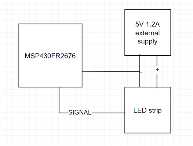

MSP430FR2676: lighting up neopixel leds using MSP430FR2676
Part Number: MSP430FR2676
Hi Team,
I am trying to replicate the functioning of adafruit neopixel leds using MSP430FR2676. I found a library online (MSP430-NeoPixel-WS2812-Library/README.md at master · mjmeli/MSP430-NeoPixel-WS2812-Library · GitHub) which had been already discussed in this forum and tried to edit it according to the datasheet of MSP430FR2676. However I wasnt able to turn on the leds. Could you please help on this I have attached the code below.
Many thanks,
Criton

  • Just by inspection, I see a couple of pieces missing:
    1) There's nothing to configure UCB0. Translating from the original, this might look something like:
        P1SEL0 |= OUTPUT_PIN;    // configure output pin as SPI output
        P1SEL1 &= ~OUTPUT_PIN;   // P1.2 as UCB0SIMO per SLASEO5D Table 9-23
        UCB0CTLW0 |= UCCKPH + UCMSB + UCMST + UCSYNC + UCSSEL_2; // 3-pin, MSB, 8-bit SPI master
        UCB0BR0 = 3;            // 16 MHz / 3 = .1875 us per bit
        UCB0BR1 = 0;
        UCB0CTLW0 &= ~UCSWRST;   // Initialize USCI state machine
    I've chosen P1.2 for you. UCB0SIMO is also available on P4.6
    2) In the line
    >  while (! UCB0IFG)
    The IFG register may have other bits set. Try instead:
                    while (!(UCB0IFG & UCTXIFG))
    I haven't tried this (I don't have one of those devices) but I think it's about right.
  • Hi Bruce,
    Many thanks for getting in touch. I made these changes still does light up. I have tried connecting the signal pin to p1.2 and p4.6. I have attached the code for your reference.
    Many thanks and Kind regards,
    Criton

  • It looks as though you lost the code that sets the CPU clock (really SMCLK) to 16MHz. ("FRCTL=" down through "while (CSCTL7".)
    That code probably belongs in main() anyway.
  • HI :),
    I didnt understand what you just explained. are you talking about the piece of code removed from the initial one which I sent that sets the clock for 16MHz? Should I keep it and try?.
  • Yes, you should put that sequence back, though probably in main() rather than in initStrip().
    Out of reset, the MCU clock (MCLK/SMCLK) runs at 1MHz, which as the author points out is too slow to get the correct bit timings. I imagine that at the lower speed everything looks like a RES pulse.
  • Thank you for getting back to me promptly. but it will have the same effect if I do it in a function as it is passed in main right? I have called it in main however still the same thing it does not light up.

    Are you fairly certain your strip is powered properly? I (vaguely) recall that a strip of 12x draws a fair amount of power.
  • Hi bruce,
    Many thanks for your response I have attached my code and circuit connections for your reference. Indeed i am using an external power supply to power the LEDS. however even after modifying the code the leds dont light the way they should. I also tried changing the number of LEDs used in the header to a few numbers.
