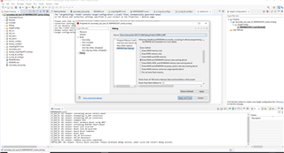

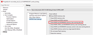

    After import the project, please also change this setting:
    Helic
  • I am pretty sure I made this change, and the error code message I received was nothing to do with.

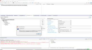

  • Please see the attached, A specific error was generated when I tried to use debugger to load the secondary bootloader into the LP-MSPM0G3507 device
    I have no problem with loading other apps into the device. Non-main section has not been erased.

    CORTEX_M0P: GEL Output: Memory Map Initialization Complete
    CORTEX_M0P: File Loader: Memory write failed: Flash loader exited with flash error.
    CORTEX_M0P: GEL: File: C:\Users\a0508911\workspace_v12_2020000\secondary_bsl_uart_LP_MSPM0G3507_nortos_ticlang\Debug\secondary_bsl_uart_LP_MSPM0G3507_nortos_ticlang.out: Load failed.
    CORTEX_M0P: NONMAIN contents corrupted, restoring to default
    CORTEX_M0P: NON-MAIN contents restored correctly but MAIN flash was erased. Fix NON-MAIN contents before re-programming.
    I got this error message from my side.
    Don't warry, this is normal.
    I have confirm that although error is printed in CCS, but secondary BSL has already load into MSPM0's Flash. (First load after a factory reset).
    I am using Uniflash to read the MSPM0 Flash 0x1041.
    Sorry for the previous mistake.
    You can confirm this by yourself.
    Also, for the previous SWD error is normal when load secondary bsl code to MSPM0:
    CORTEX_M0P: Error: (Error -614 @ 0x0) The target indicates there is an error condition from a previous SWD  request. Clear the error the condition, and try the SWD request again. (Emulation package 20.0.0.3178)
    CORTEX_M0P: Trouble Halting Target CPU: (Error -2064 @ 0x0) Unable to read device status. Reset the device, and retry the operation. If error persists, confirm configuration, power-cycle the board, and/or try more reliable JTAG settings (e.g. lower TCLK). (Emulation package 20.0.0.3178)
    CORTEX_M0P: Unable to determine target status after 20 attempts
    CORTEX_M0P: Failed to remove the debug state from the target before disconnecting.  There may still be breakpoint op-codes embedded in program memory.  It is recommended that you reset the emulator before you connect and reload your program before you continue debugging
    This is caused by SWD interface. It's normal that after Flash secondary BSL.
    If you want to update the BSL, it's better to run a factory reset before download the secondary BSL.
