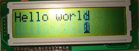

Hi, I did not like any library for handling the LCD so I write her but I do not know what to do next .... where's my mistake? Thank you very much.
#include <msp430g2452.h>
#define LCD_DIR P1DIR
#define LCD_OUT P1OUT
#define LCD_PIN_RS BIT0
#define LCD_PIN_EN BIT1
#define LCD_PIN_D4 BIT2
#define LCD_PIN_D5 BIT3
#define LCD_PIN_D6 BIT4
#define LCD_PIN_D7 BIT5
void PulseLCD(void)
LCD_OUT |= LCD_PIN_EN;
__delay_cycles(2000);
LCD_OUT &= (~LCD_PIN_EN);
void SendBite(char data)
if(data & 0x01)
LCD_OUT |= LCD_PIN_D4;
else
LCD_OUT &= ~LCD_PIN_D4;
if(data & 0x02)
LCD_OUT |= LCD_PIN_D5;
else
LCD_OUT &= ~LCD_PIN_D5;
if(data & 0x04)
LCD_OUT |= LCD_PIN_D6;
else
LCD_OUT &= ~LCD_PIN_D6;
if(data & 0x08)
LCD_OUT |= LCD_PIN_D7;
else
LCD_OUT &= ~LCD_PIN_D7;
PulseLCD();
void SendInstruction(char data)
LCD_OUT &= ~LCD_PIN_RS;
SendBite((data>>4) & 0x0F);
SendBite((data) & 0x0F);
void SendByte(char data)
LCD_OUT |= LCD_PIN_RS;
void InitLCD(void)
__delay_cycles(100000);
SendInstruction(0x02);
SendInstruction(0x0C);
SendInstruction(0x01);
SendInstruction(0x06);
void LCDSetPosition(char Row, char Col)
char address;
if (Row == 0)
address = 0;
else
address = 0x40;
address |= Col;
SendInstruction(0x80 | address);
void LCDClear(void)
void LCDGoToHome(void)
void LCDShiftLeft(void)
SendInstruction(0x18);
void LCDShiftRight(void)
SendInstruction(0x1C);
void LCDBlinkCursor(void)
SendInstruction(0x0F);
void LCDPrintString(const char * Text)
while (*Text)
SendByte(*Text++);
