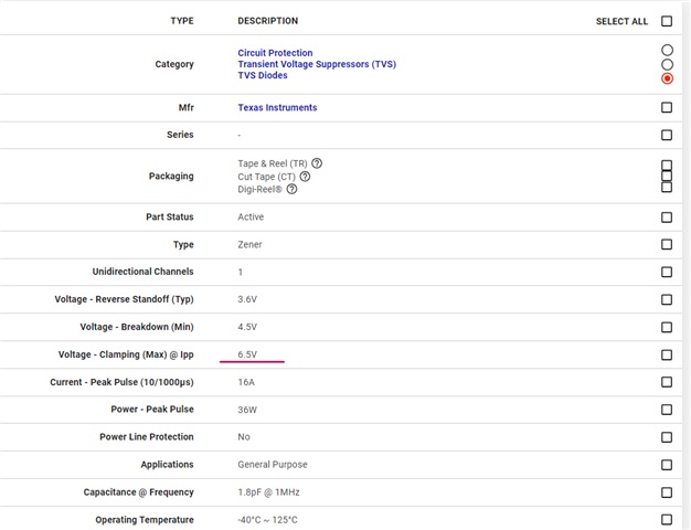

    One more question.
    Below Image is our case just assume,
    MSP34 abs Max ratting 3.6V
    ESD diode Clamping is 6.5V as per datasheet.
    During normal operation this ESD diode operate like open circuit.
    During my transient spike this will start biasing this case ESD diode clamp voltage is 6.5V, the same 6.5V enter to MSP340 and this is higher than 3.6V
    this case how this will protect the MCU?
    or Across the ESD diode clamp voltage is 6.5V but sue the MSP340 internal protection diode will take a role protecting this voltage VCC+Vf (diode Frwd drop) ?
    Please provide your suggestions on this.

  • You should read slaa530, MSP430 System-Level ESD Considerations.
  • Hi Ganesh,
    Let me consult with my team on this. I would recommend to read the guide that David recommended (specifically the TVS Diodes section) in the meantime.
    Diego Abad
  • Hi Ganesh,
    If you can change the Diode to an ESD351, it will guarantee a good range of protection for the MSP430 line. Alternatively, you can add a current-limiting resistor before the ESD diode input to improve performance.
