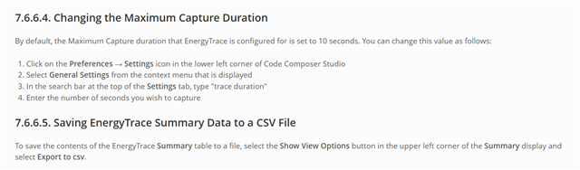

I am using CCS version: 20.0.2.5__1.6.2. When I use Energytrace and Energytrace++, my measurement time is only 10 seconds. Can I increase it up to 10 minutes or 1 hours?. Moreover, can I save data into csv or txt file?
