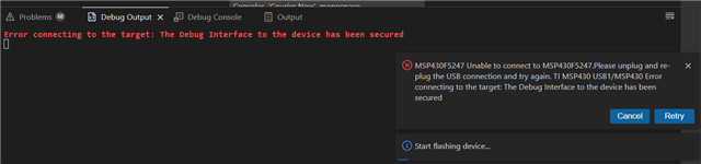

I am facing this error:

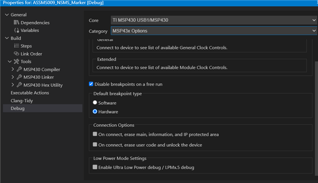

I was not able to select as it was disabled "On connect, erase user code and unlock the device"
Please help.

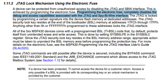

Hi Luke,
Have you programmed this device before? There is an e-fuse on the device to disable debug access (this is a security feature for when a device is deployed into the field).
