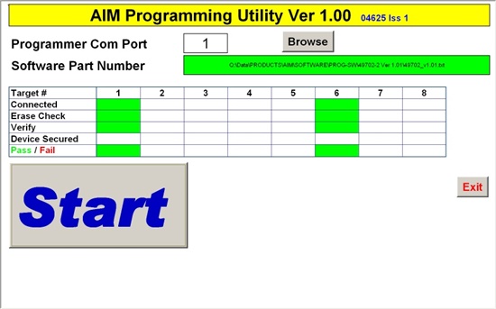

    My app is intended to make the programming  cycle idiot proof i.e. users can't mess with settings etc.I've ttached a screenshot.
    Unfortunately not. :(

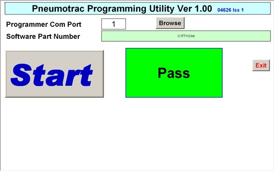

  • I've attached screenshots of the 8 Gang Programming workbook and also one I did for the Single MSP-PRG430 Programmer
    The Excel Interface is totally hidden from the user.
  • Looks nice. Exactly the type of program one needs for the production department, where no engineers are working on the devices. Just plug and click
