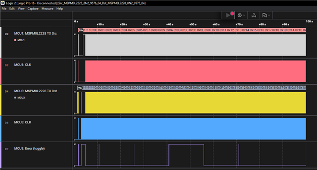

In the following I have provided 3 pictures showing what the logic analyzer has captured while two MSPM0L228 modules are communicating with each other.
Both boards are set up with 8 data bits, no parity and 2 stop bits – and a baud rate of 9576 (via syscfg).
The transmitting code sends a byte - increment it and sends it again.
The receiving code receives a byte and validates that it is one higher than the previous received byte - if not it toggles PA25 - regardless of if it was a match or not the byte is transmitted.
MCU1: MSPM0L2228 TX Src // TX from the source MSPM0L2228 board // (PA8_UART1-TX (Source MSPM02228 board))
MCU1: CLK // LFCLK from the source board // (PA27 (Source MSPM02228 board))
MCU3: MSPM0L2228 TX Dst // TX from the destination MSPM0L2228 board (the board echos out what it received from the source board) // (PA9_UART1-RX (Destination MSPM02228 board))
MCU3: CLK // LFCLK from the destination board // (PA27 (Destination MSPM02228 board))
MCU3: Error (toggle) // GPIO from the destination board that is toggled every time the board receives a byte out of sequence. Usually there will be two toggles right after each other – one on each side of the incorrect byte //  (PA25 (Destination MSPM02228 board))
PA8_UART1-TX (Source MSPM02228 board) connected to PA9_UART1-RX (Destination MSPM02228 board)
Ground connected between the two boards.

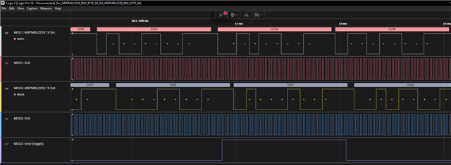

First picture shows the entire communication (100s) between the two boards. Every state shift in the MCU: Error (toggle) indicates a byte received out of sequence.
Second picture shows a close up on one of the errors. The byte 0x99 is incorrectly received as 0x91.
The last picture is further zoomed in so the clocks from both boards are easier to see.
Let me know if more info is needed.

    If they were using the same 32KHZ clock, yes. If not, then no.
    As shown in you scope captures, bit times are either 3 or 4 clock cycles.
    The receiver detects a start bit and then begins receiving data. But its clock is not aligned with the transmit clock so there can be a lot of delay here. Up to one cycle of the receive clock. In the 3X oversample mode, the receiver samples each bit on its second clock. (Unknown is what its clock looks like.) This puts the sampling time perilously close to the end of the transmitted bit. Add in delay from async clocks and there will be trouble.
    I expect that an 8X oversample mode would work better if a bit slower.
