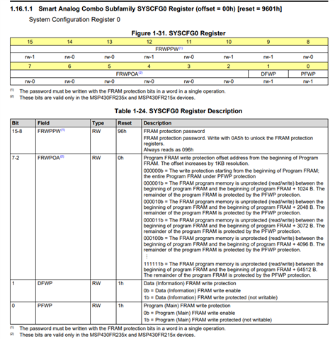

    3. What are the contents of the SYSCFG0 register? See below:
    Owen

    Without any context to the video, there's no way for me to understand how your code is written and intended to execute. The only thing I'm seeing in the video is that instead of reading or writing 16 bits, you're reading or writing 24 bits.
    You mentioned that you don't find errors when you write to FRAM, but how do you know this? Can you confirm that the data you want written to FRAM is actually being written? It seems like the data may not be written to FRAM. Could be an issue with protection.
