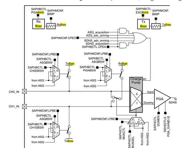

From the diagram, I would like to understand the importance of the Rx Bias and Tx Bias voltages.
  1. Why is biasing needed, especially when the PGA input is limited to a maximum of 800 mVpp?
  2. My understanding is that adding a bias might cause the input to exceed this 800 mVpp limit, depending on signal swing. Should I be concerned about this?
  3. Do I need to carefully consider both Rx and Tx bias settings, or are they internally isolated such that they don’t affect each other directly?
Could you please help clarify how biasing interacts with PGA input range and what precautions should be taken in setting these voltages to ensure the signal remains within allowed limits?
    1. The RX bias voltage is needed because we do not want negative voltage goes into the MCU. TX bias is used to protect overshoot while excitation.
    2. You should concern the RX bias voltage plus the receive signal not exceed 800mVpp limit.
    3. TX and RX bias are internally isolated. They do not affect each other.

  • So from the datasheet , can i interpret following points.
    1. Since maximum allowed setting for RX bias is 950mV, and maximum allowed swing is 800mV. So the maximum allowed common mode voltage for PGA is 1350mV and 550mV
    2. if i consider a swing of 1000mV it is 1450 to 450mV.
    Is my interpretation correct?. if yes then my input signal +RX bias should honour these ranges so that their is no damage to PGA. In view of the same kindly suggest should i consider 1000mV or 800mV as datasheet suggests for both values
    Secondly suppose my signal +RX bias is well within 1350mV to 550mV, but  above the criteria of 800mv(pk-pk), then in that case what would be the impact on delta tof .
    Consider i have an Input signal of 520mV (0-pk) and i keep RX bias as 750mV, so i pre-assume i am within the common mode specs but 800mV(pk-pk) is not meeting, so what is the long term or short term impact on flow metering. And how can i compensate for this
    Your interpretation looks correct to me. For PVCC >= 2.5V, you can consider 1000mV.
    For above the criteria of 800mv(pk-pk), I would say it could impact the tof calculation.
    An input signal of 520mV (0-pk) could cause signal clipping on the ADC captures. The ADC(SDHS) reference voltage is 755mV. You do not want the ADC input signal exceed this range(0-755mV) to avoid clipping issue.

  • if ADC reference voltage is +755mV, and if  bias included on AC , then bias voltage itself is equivalent to signa
    The PGA can be set to negative gain value. Your concern will not be an issue.
    Cash Hao
  • So, I apply bias,voltage level reach to 1350 mV peak and i have to apply negative gain such that the 1350 mV become less than its reference 775 mV?IIs my observation is correct...
  • i want to know that the Gain is applied on (Rx-Bias + Received signal )or only on received signal ?
  • I would say it is applied on both bias and receive signal.

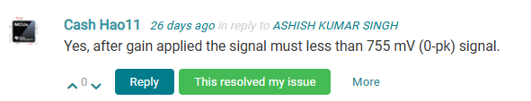

  • so as per my observation the received signal before gain not more than 1000 mV peak to peak or it means the difference between max peak and min peak not more than 1000mV.And after gain applied the signal must less than 755 mV (0-pk) signal.Is my observation is correct?
  • Yes, after gain applied the signal must less than 755 mV (0-pk) signal.
