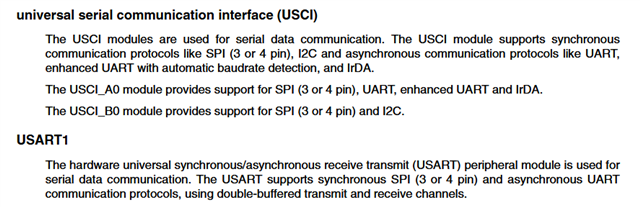

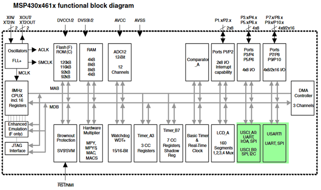

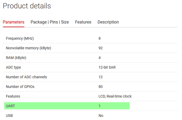

does the MSP430F4616 support two UART ports? Because the product page is claiming that the device has one UART port only, but when checking the datasheet I see that it has an USCI and an USART port, which both can do UART. Can you help me to understand which number is correct?
Is there any limitaton which provents to use two UART ports in parallel?
