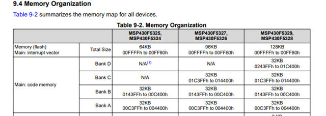

    (1) The product writes to Information Memory C and D to memorize settings.
    Is it possible that an error occurs during the operation and 00 00 is entered and the value is shifted?
    I am little confused why there will have the write behavior for Memory C and D. As I checked the datasheet description, there only has Memory A and B for MSP430F5324:
    (2) Is it possible that external noise occurs in the product and 00 00 is written and the value is shifted?
    (3) Is it possible that 00 00 is written and the value is shifted due to timing shift such as noise during microcomputer writing?
    I think after it successfully write, the value will be constant unless there has any write behavior in the application code.
    During the write process, there do has possiblity that the value is impact by external noise.

  • Hi Ito,
    Can you help share more details of the memeory data issues.
    When reading the contents written to the defective MCU via BSL communication, “00 00” was found, and the values were partially off.
    What memeory address range has this issues?
    What is the expected value? Is the all the failed device has the same failed address, or they are random? And what is failure rate?
    Meanwhile, will the app manually use flash controller to program the specfic address?
    And, may I know how you lock the device - you should load some data into 0x17FC to lock it, correct?

  • Additionally, update some comments regarding as your question post here.
    1. Is it possible for a defect like this to occur outside of the writing process? (We want to determine if it occurs during microcontroller writing or after the product enters the market).
    Yes, out of programming, if there has overspec happens to MCU, such as overvoltage or over current (voltage is more often), then it might make the flash data been tampered with
    2. When a Verify error occurs during programming with MSP-GANG, do the values written to the microcontroller remain intact?
    Yes, verify should only do read and check. Does not impact the firmware itself.
