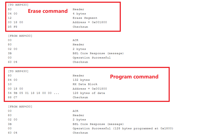

I need to save some data in INFO D, from address 0x1820 to 0x1823. That means when I generate TI txt, the data in the TI txt will be like
@1820
01 02 03 04
@4400
4F 14 F1 03 C1 43 00 00 E2 B2 3E 09 06 24 B1 13
0C 92 C1 4C
q
Can I use BSL to program the TI txt like above? Or can we directly save data in INFO when generate TI txt?
ZJY
    You can use BSL to program INFO memory. And you can also directly save data in INFO in txt file.
    Cash Hao
  • Hi Cash,

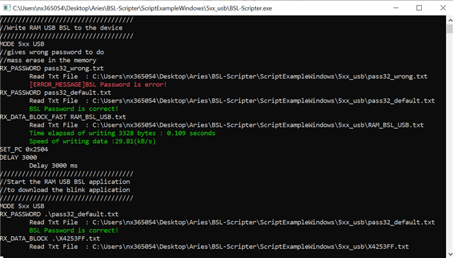

    I tried BSL programming with BSL-Scripter.exe (MSPBSL_Scripter 3_04_00_02 - TI.com) and the TI TXT to program is like following

    But the exe always keeps in this step and does not go on any more.
    I want to know why this happened?

  • I would suggest to call separate erase and program command on information memory.
  • Hi Cash,
    That is to say I can not use the general BSL-Script tool which is provided by TI to program INFO, but need to use special command to finish this. Right?
    ZJY
  • I would say yes.
