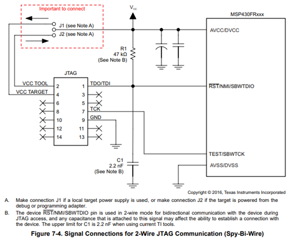

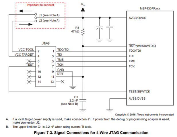

Hi MSP experts,
the usermanual of the MSP430FR6xxx mentionts that the RST Pin should have an 47kOhm + 2,2 nF. But are these numbers really the only option which guarantees a stable operatoin or can there also be deviatoins to it?
Especially how about these combinations?
  • 47 kOhm + 1 nF
  • 100 kOhm +  2,2 nF
  • 47 kOhm +  1,1 nF
Furthermore, are there specifications on the tolerance on the resistor and capacitor? Expecially on the temperature characteristics of the MLCC?
Thank you,
Marinus
