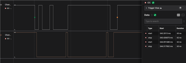

I'm currently using an MSP430G2231 as an I2C slave and have noticed a strange phenomenon:
during I2C communication, if the master sends a write command directly to me, there's a certain chance it will fail.
However, if it first executes a read command and successfully reads the data, the subsequent write command will also complete normally.
I initially suspected that I might be failing to release the interrupt flag somewhere.
I'm using the example code msp430g2x21_usi_15.c and modifying it.
msp430g2x21_usi_15 seem slightly different from MSP430G2231, but can I still use it?
If so, I'm using this example program and still encounter the same problem.
This is my current code:

  • 1) Are you using example usi_12 for the Master, or something else?
    2) What does "fail" look like? (NACK? Bus hang? Wrong data?)
  • Thanks!

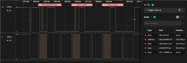

    1. I using a DoThink as my I2C master , and it can w/r my EEPROM well.
    2. I think it seems link a bus hang , the master didn't active the SCL to me to receive data.
    both is the waveform of i2c write
  • I'm not familiar with the DoThink, but in the first trace it appears to be ignoring the clock-stretch after the Start. I suppose the stretching is from the USI, based on USISTTIFG. However it seems to recognize it in the second trace.
    The USI, for its part, is holding onto the clock-stretch for a long time in the first trace, as though it missed the USISTTIFG (wrong state?).
    Does this happen on every write, or only if it's the first? I.e. does a single read seem to clear up the condition forever?
