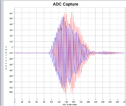

    but during the measurement process, I observed that the DTOF window sometimes undergoes sudden changes,like this:
    It often occurs during periods of big flow.
    I need to find out the cause of this phenomenon and then solve it.

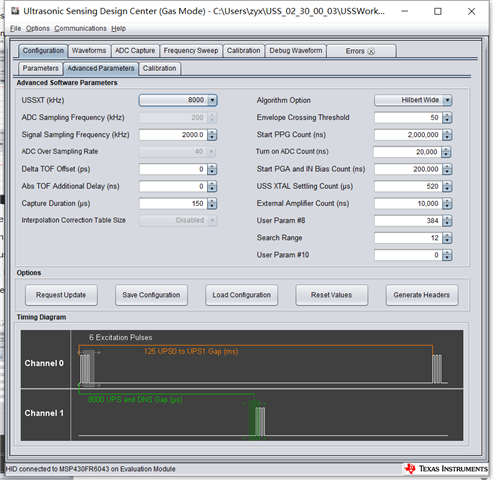

    then,about the ultrasound excitation pulse, my ultrasonic transducer operates at a frequency of 500 KHz.
    I use the follow setting:

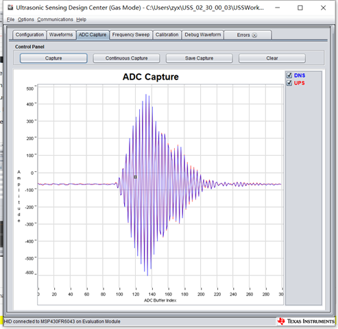

    the ADC Capture like this at 0 flow:
    and this at 6m3/h flow:

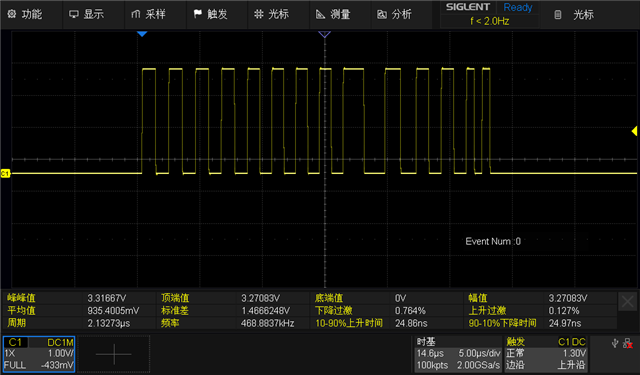

    I observed the excitation signal through the oscilloscope as follows:
    except 8 x-pulse and e-pulse, There are an additional 6 pulsesn, and no s-pulse.
    I think this additional pulse might be the cause.

  • Supplementary configuration diagram:
  • It looks like there is cycle slip issue on the TOF results. I think it is related to the 500k transducer. I would suggest to change to 200kHz transducer. It will significantly lower the cycle slip issue rate.
    The additional 6 pulses should be the stop pulses. It can be controlled by the User Param#8.

  • The issue is that this transducer you are using is not that sensitive to the excitation pulses. I would assume you are testing with air. And you will need 12.2dB PGA gain setting to get a proper ADC capture data in air. If you change air to methane or other gases, you will need a higher PGA gain setting. It is not what we want here. A higher PGA gain setting means the original signal is small with poor SNR. A signal with noise would cause cycle slip issue you are seeing here. If you keep want to use 500kHz transducer, then try with a different manufacture. The current one does not fit USS solution.
