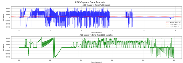

Since I don't have access to the USS design center adc capture for a log file I created my own gui to plot the capture, and this is what is displayed for all the data gathered from a capture except for the preceding -1 elements.

  • Yes, I have that board, but I also have a board that I designed. I want to verify that the board that I designed is working correctly on the ADC capture from the transducers.

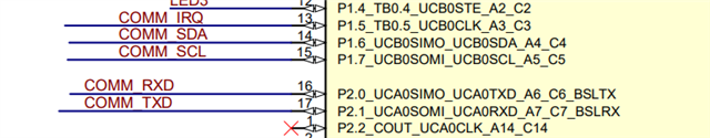

    And yes, is there a way to get connected to my MSP430FR6047 board that I designed using the USS design center? I have the EVM430-FR6047. Could I jumper the connections from the HIDbridge protion of the  EVM430-FR6047 to my board?
    I have these pins of the MSP430FR6047 brought out to a berg header on my card:
    Can I use these to connect to the EVM430-FR6047 to my board?
    Otherwise what section of the data that comes from this method USS_getUPSPtr(config);  is the adc portion? it is parsed on your tool so why can't I do on mine.

  • Hi Toby,
    Sorry for reply you later due to holiday,
    Yes, you can connect your board to USS design center via below method:
    I2C_SCL, I2C_SDA, I2C_IRQ.
    PS: We will recommend I2C interface due to speed will faster than UART.
