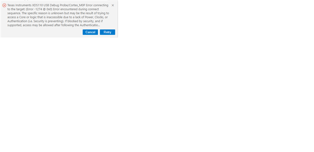

Good day TI Team,
Summary:
While programming "mcubootblinky" example into LP-CC2340R5 through 10 pin cable using debugger of LP-MSPM0L1306,
the LP-CC2340R5 has been corrupted.
Please guide us to recover LP-CC2340R5 and to continue programming other examples.
Details:
While trying to load the example - simplelink_lowpower_f3_sdk_9_12_00_19\examples\nortos\LP_EM_CC2340R5\mcuboot\mcubootblinky
into LP-CC2340R5 using the below connection
We are getting the error in below sequence:
  1. Target not connected
  2. During next try getting error - 1274 @ 0x0
  3. After that same error continued for any example.
We tried two boards; both the boards are not working now.
It looks this example corrupt the boot area of MCU.
So that not able to program after try to programming this example.
Please guide us to recover the board LP-CC2340R5 and to program the other example.
Note: Board was able to program for the example: C:\ti\simplelink_lowpower_f3_sdk_9_12_00_19\examples\nortos\LP_EM_CC2340R5\drivers\gpiointerrupt
