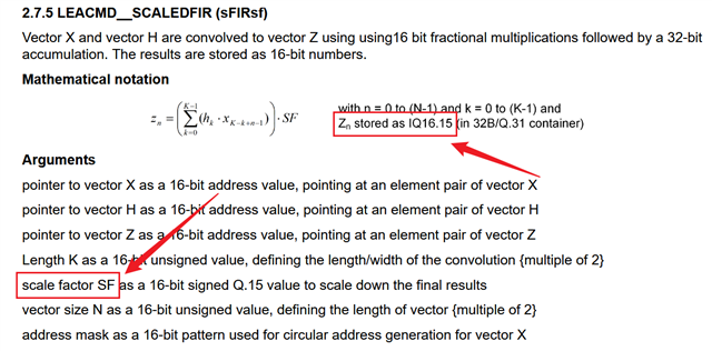

I don't know how to use lea command (LEACMD__SCALEDFIR).
     question 1: Which variable should I assign Scale factor SF to?
     question 2: What does the data format of Zn in the output result mean, and how should it be converted to a floating-point number?
     I need an example to help me understand this command  (LEACMD__SCALEDFIR).
