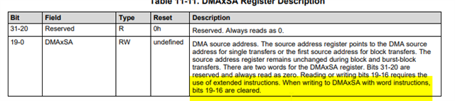

    Hmmm. I was just looking at the GCC version of __data20_write_long() and something is very wrong with it.
    #define _data20_write_long(addr,src) \
            unsigned int __tmp; \
            unsigned long __addr = addr; \
            __asm__ __volatile__ ( \
            "movx.a %1, %0 \n\t" \
            "mov.w  %L2, 0(%0) \n\t" \
            "mov.w  %H2, 2(%0)" \
            : "=&r"((unsigned int) __tmp) \
            : "m"((unsigned long) __addr), "ri"((long) src) \
    After the expected movx.a instruction, there are two word writes. Which completely destroys the intent and zeros out the upper word when used with DMA address registers. In the past there was a __data20_write_addr() that didn't have this redundant and faulty write.
  • Oh, I suspect that the system crash is a power up clear (PUC) from accessing vacant peripheral space.
    Lots of ways to check this. Examining the generated code being the simplest.

  • I don't have a device with CRC32 handy but I did run this code on the fr5969 with no trouble:
    int main(void)
      DMA0CTL = DMASBDB | DMASRCINCR_3 | DMADT_1;
      DMA0DA = &CRCDIRB_H;
      __data16_write_addr(&DMA0SA, 0x10000L);
      DMA0SZ = 0xffff;
      DMA0CTL |= DMAEN;
      CRCINIRES = 0xffff;
      DMA0CTL |= DMAREQ;
      while (1);
  • with the 16 bit address range it also works on my side. the problem is with the 20bit address range
    Break it up into smaller parts.
  • I have to jump to higher addresses (20bit) with the dma independent from the chunk size, and it looks like, that this is the problem.
  • It shouldn't be. At least with GCC I get reasonable code and the expected behaviour.

    I just noticed somethin else: When using the DMA function in the lower addresses (16Bit) it works fine, but when using the higher FRAM area the device stops working.
    I also found this note from the datasheet:
    But let me show what I'm doing:

  •     // Set the Destination Address (20-bit)
        __data20_write_long((uint32_t)&DMA0DA, dst_addr & 0xFFFFF);
    This uses two 16 bit writes. See  SLAU132.
