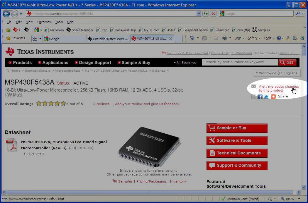

MSP430F543xA, MSP430F541xA Mixed Signal Microcontroller (Rev. B) (PDF 1016 KB) 15 Oct 2010
Page 18 of 104
