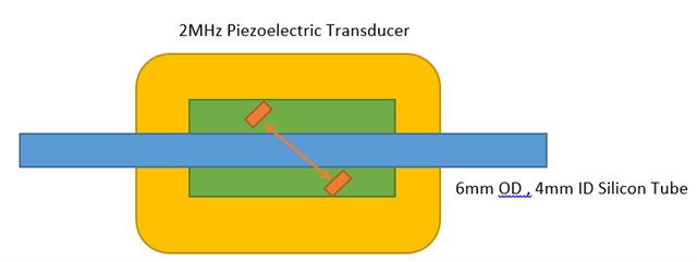

I have designed a water flowmeter using MSP430FR6047 by using MSP430FR6047 EVM as a reference so that it works with the Ultrasonic Sensing Design Center. Please see ADC Capture and the Waveform captured for Delta ToF. The noise level is quite high. Attached is the USS_userConfig.h that is used in my firmware.
Any advice on what could be causing the high noise level
USS_userConfig.h
    The ADC waveform is not good here, can you show your configuration picture, and which transduce you used?
    Can you share your hardware connection? Include water pipe.

    Thanks for your reply.
    The ADC waveform is not good here, can you show your configuration picture, and which transducer you used?
    Can you eloborate about the not good. I just need to know what to expect and what is the ideal kind of waveform.

    AS for the hardware setup, I can show u the sketch of the setup. The signal ultrasonic transducer input is weak. As you can see from the attached file, I used maximum gain. The measure AbsTOF is only about 7us with tube and liquid as transmission medium. There are a few noob question I would like to ask
    1) What is the best way to secure the piezoelectric transducer. Any recommended adhesive?
    2) How to improve the strength of the ultrasonic transmission? CAn I use a buffer to drive the transducer (5V or 12V)
    3) If both Upstream and Downstream transducer is connected on the same frame, wouldn't the ultrasonic vibration transmitted through the frame or the the sidewall of the tube?
    See my comments as below:
    Good waveform as your reference:
    [ANS]For metering transducer, the power is small, thus will don't have mechanical shack, use  some simple method should be fine.
    [ANS] yes, but you will need external circuit, MSP430FR6047 EVM only support 3.3V.
    [ANS]Not impact, this is common use case.
