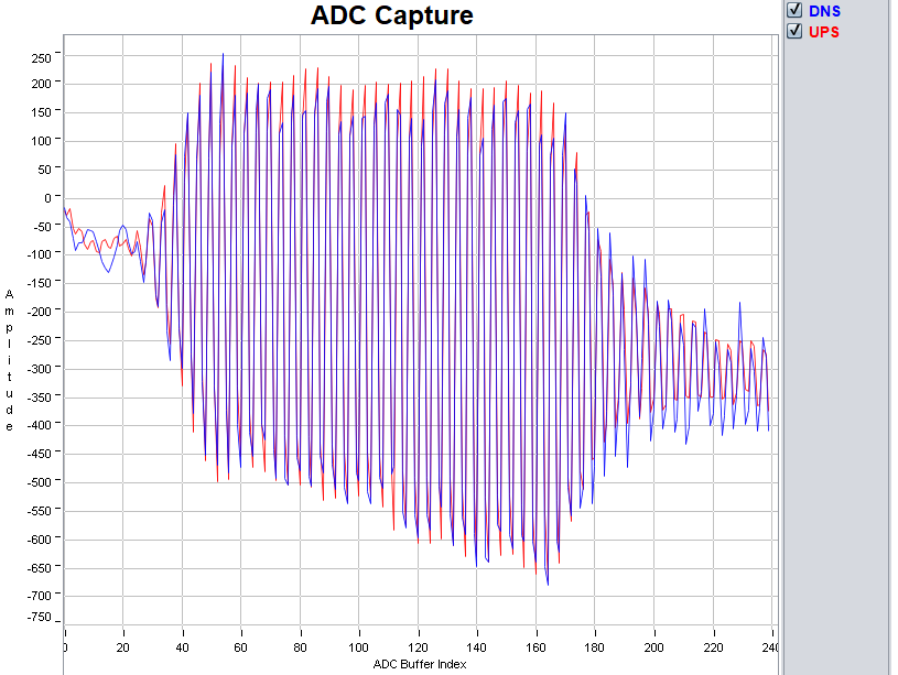

I’ve designed a system using the MSP450FR6047 with an externally controlled front end similar to the TIDA-01486 reference design.
My ADC capture looks like this, and I’m concerned about the downward-trending lobe in the waveform. What could this indicate? Does it suggest that I need larger DC-blocking capacitors in the receive path?
    A downward-tilted lobe is a typical manifestation of baseline drift and bandwidth limitation caused by insufficient DC-blocking capacitance (or excessive ESR/ESL). You can try increasing the blocking capacitance at the receiver (and selecting high-precision, low-ESR ceramic capacitors) and checking the matching network.
