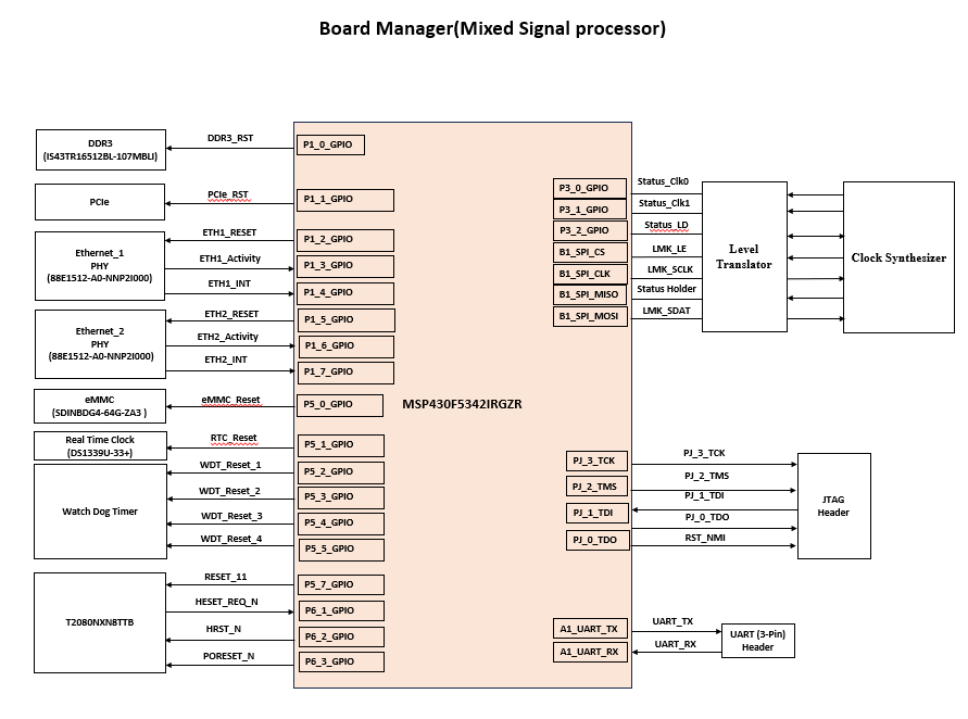

We are using an MSP430 microcontroller from Texas Instruments to generate and control the reset signals for all interfaces connected to the NXP T2080 processor, including the POR reset.
Please confirm whether we can use the MSP430 to control and manage all reset interfaces between the MSP430 and the NXP T2080 processor as shown in the attached block diagram.
