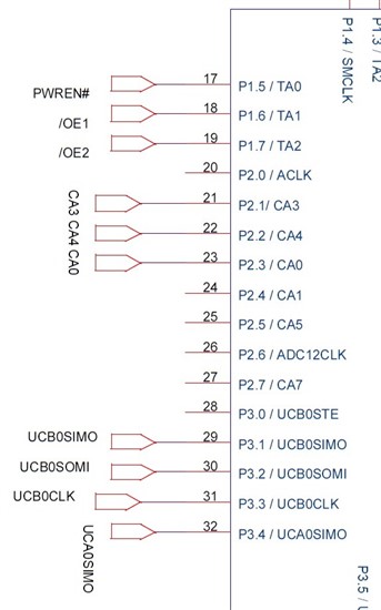

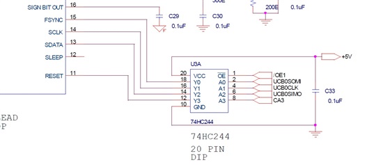

  • Hi Roberto,
    Thanks for the quick reply.
    Roberto Romano said:
    you posted twice the same
    sorry about that.
    please post again exact MSP part number and where you connected spi signal.
    MSP430F2619, SPI connected to
    UCBOSIMO = P3.1
    UCBOSOMI = P3.2
    UCBOCLK = P3.3
    UCB1SIMO = P5.1
    UCB1SOMI = P5.2
    UCB1CLK = P5.3. Hope this helps.

     Hi Janmay, again there where some confusion we need narrow down to single wire:
     Yellow marked bit connect to P3.x and belong to channel B instance 0
     Green marked bit connect to P5.x and belong to channel B instance 1
    Which channel is connected to DDS chip? Why are you using both instance of channel B?

    My schematics: The 74HC244 is the buffer.
    The MSP430 pins:
    Thanks in advance.

     Port P1 P2 P3 are not initialized, I assumed your programming skill and MSP knowledge was more than newbie, still RESET must be asserted then released and also check sleep pin remain at low level, every case connect an 1K resistor from pin12 to ground, otherwise AS9834 can enter sleep mode.
     When checked pin 12 is low try this revised code..
