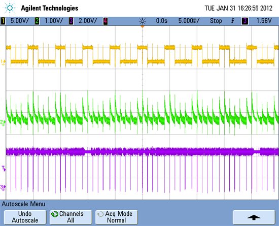

For quite some time i have been trying to communicate (write the required hex word) to the AD9834, a Sig-Generator IC.
But i have been unsuccessful.
During subsequent experimentation with the code, i decided to capture the waveforms of the CLK, SIMO and SOMI pins.
The datasheet of the AD9834 states that "After FSYNC (SOMI) goes low, serial data is shifted into the input shift register of the device on the falling edges of SCLK for 16 clock pulses. FSYNC (SOMI) can be taken high after the 16th falling edge of SCLK"
Now i captured all the three signals during program execution, and this is how they look.
Top/ 1 / yellow = SIMO pin
Middle / 2 / Green = SOMI pin
Bottom / 3 / purple = CLK pin
The clk waveform looks weird to me.
I have the following doubts?
1) Does the CLK waveform look satisfactory?
2) Are my initializations correct?
3) What are the possible reasons because of which my code fails to work?
I would be eternally grateful, if someone could help me out.
PS : (I, II, III, IV and V are the 16bits of data (words) i am entering)
    This really doesn't make sense. SOMI is slave output master input signal, and it has to be provided by teh slave for each individual clock pulse, forming the data the slave wants to send to the master.
    THe description, however, reads like FSYNC(SOMI) is a control signal.
    Now SPI usually requires an additional control signal, usually called CS. This signal mus tbe provided usign a normal GPIO pin of the MSP. It 'selects' the slave (remember, SPI is a bus) and also synchronizes the slave to a byte border.
    So if CS goes low, the slave knows that the next clock edge is the first bit of data meant for him. If CS goes high,. the slave knows that he i s not addressed anymore, and shall shut up and ignore any clock pulses.
    Your scope printout seems to confirm this: it looks like you have two outputs fighting on SOMI. (also, the clock doesn't look good too. maybe there's even more wrong)
