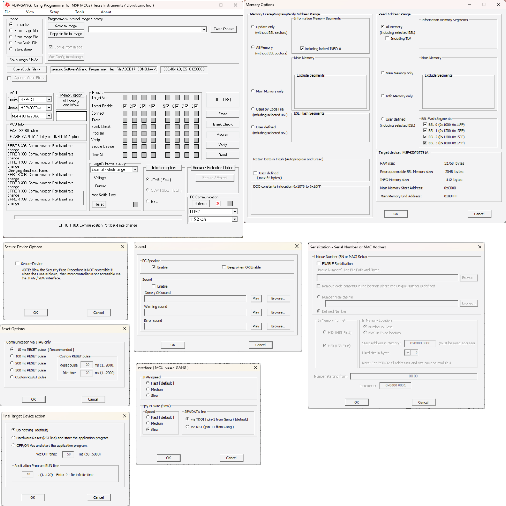

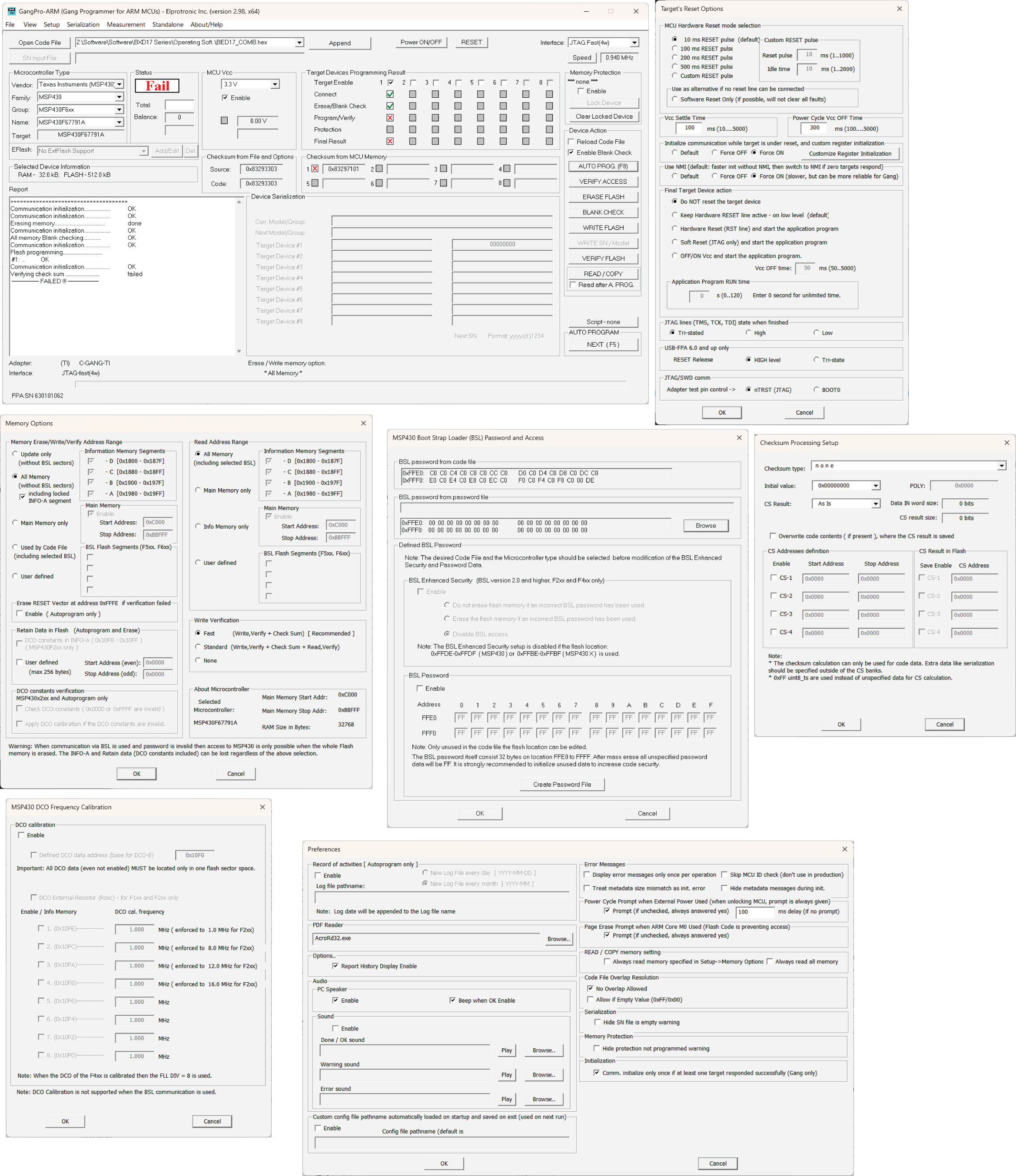

We’re trying to get the C-Gang with splitter PE063X06 working with the MSP430F67791A, unfortunately whatever we try we are always getting a checksum error at the end of the auto program process.
Previously we were using an MSP-Gang, but it has died. As much as is possible, we’ve replicated the configuration of software in GangPro-ARM (screenshots below), but it always results in a failure.

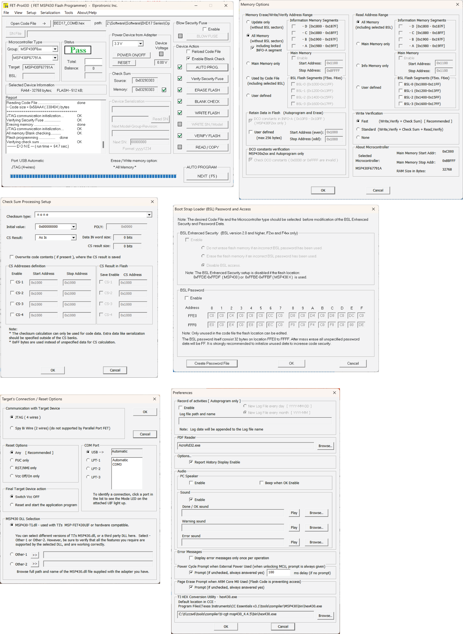

The in-circuit MSP430F67791A processor will program with an MSP-FET and FETPro430 Lite (further screenshots below).

Previous MSP-Gang setup
New GangPro-Arm setup
MSP-FET with Fet-Pro430 setup
