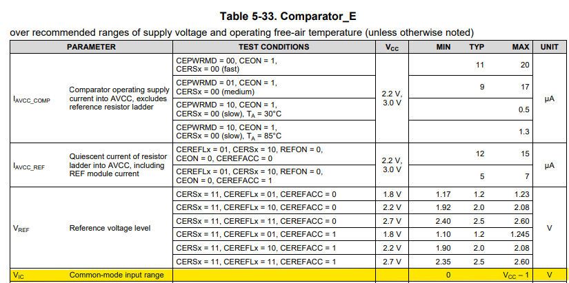

As described below, the common-mode input range (VIC) of Comparator_E is set to "VSS~VCC-1".
Could you tell me what happens if a voltage exceeding VCC-1 is input?
If the value exceeds the MAX value but is less than VCC, is it correct to assume that it will not break, and will behave as if it is the MAX value? For example, if VCC=3.3V, the negative terminal is fixed at 0V, and the positive terminal is set to 2.4V or higher, will the comparator treat it as if + terminal = 2.3V is input?

  • For your example of input voltages of 0V and 2.4V, the common mode voltage is 1.2V.
    Could you please tell me the formula used to calculate 1.2V?
    Do you have an answer to the above question?
    I'd like to know how the comparator behaves when a voltage of VCC-1 or higher is applied to its + input pin.
    O.H
  • Could you please tell me the formula used to calculate 1.2V?
    Common mode is a widely known concept. There is even a page at Wikipedia so I am not going to do that again.
    Exceeding the common mode input range will lead it undefined results. So don't do it.
