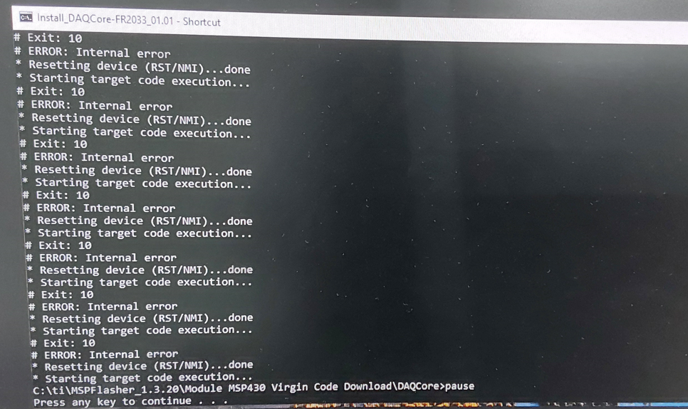

We are unable to load the MSP flash program in the "IC 16-bit Microcontroller 3.6V RISC 16MHz 64-LQFP". Please refer to the attached image for a better understanding.
Ok  below:unnamed.png
Error below :

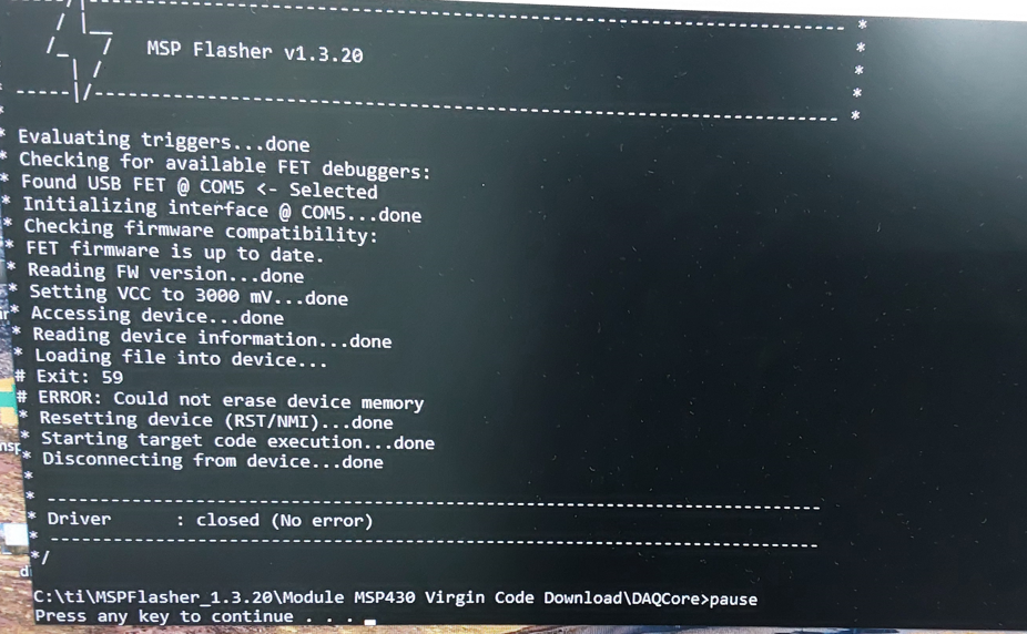

    The error code 59 means that EEM polling thread is already active. The error code 10 means Could not set device Vcc.
    Does this issue persist if you try it on another computer?
    Have you tried power cycling the device? Factory resetting?
    What is your configuration for the flasher? Is it supplying power? What other trigger/arguments are you using?

  • Hi Arulmaria,
    It's not clear to me if the MSP-FET is supplying the power to the device, or if the device is being externally powered. Have you tried both configurations?

  • Hi Owen,
    Please find the argument details attached below. Regarding power supply, the source for the component is from the main frame.
  • Hi Arulmaria,
    Thanks for sharing.
    1. Can you program the device using CCS or Uniflash with the MSP-FET?
    2. Can you share the connection between the MSP-FET and the device (i.e., a diagram of the connections)?
    3. Uninstall the MSP Flasher software and reinstall it.
