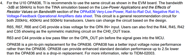

1. Based on the EVM430 development board, how to optimize the capacitor and resistor matching of the operational amplifier circuit for a 200K transducer and a 500K transducer?
