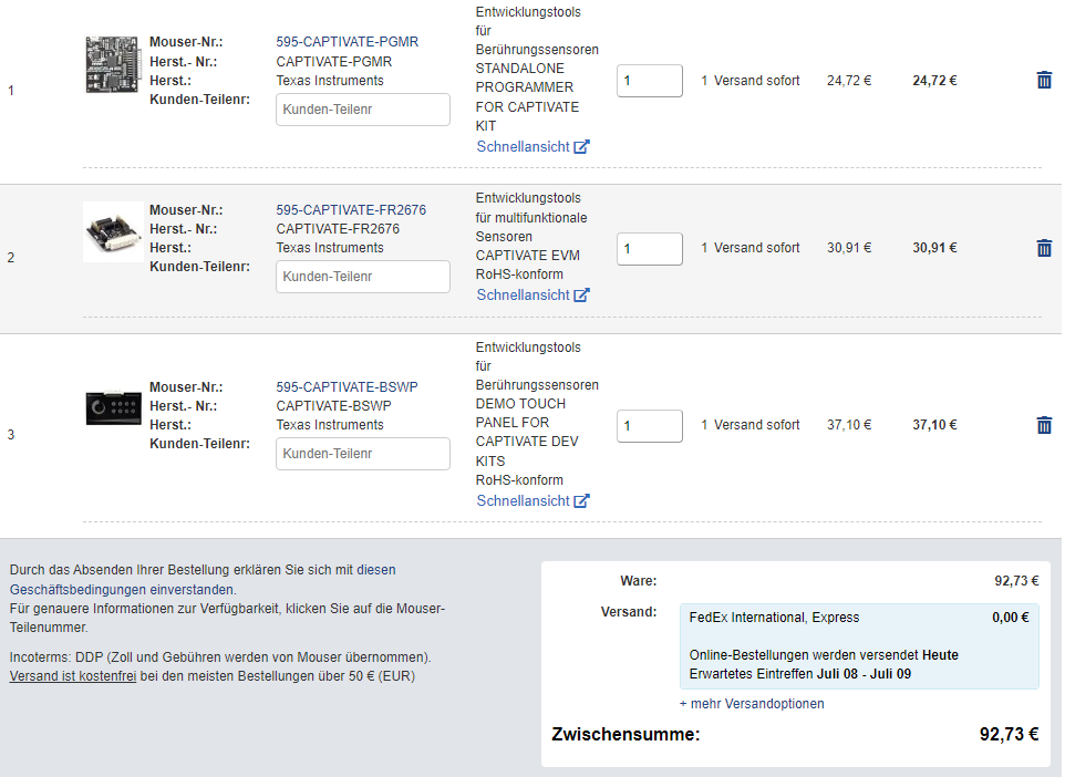

We are currently working with the CAPTIVATE development setup from Texas Instruments. Instead of using the BSWP demo panel, we have integrated industrial textile-based capacitive sensors into our system, and the sensing functionality itself is working well.
However, we are facing an issue related to the sensor connections. Since the textile sensors are connected via external wires, we observe that the measured capacitance changes significantly when a human hand or body comes near the connecting wires. This suggests that the wiring is highly sensitive to external interference.
