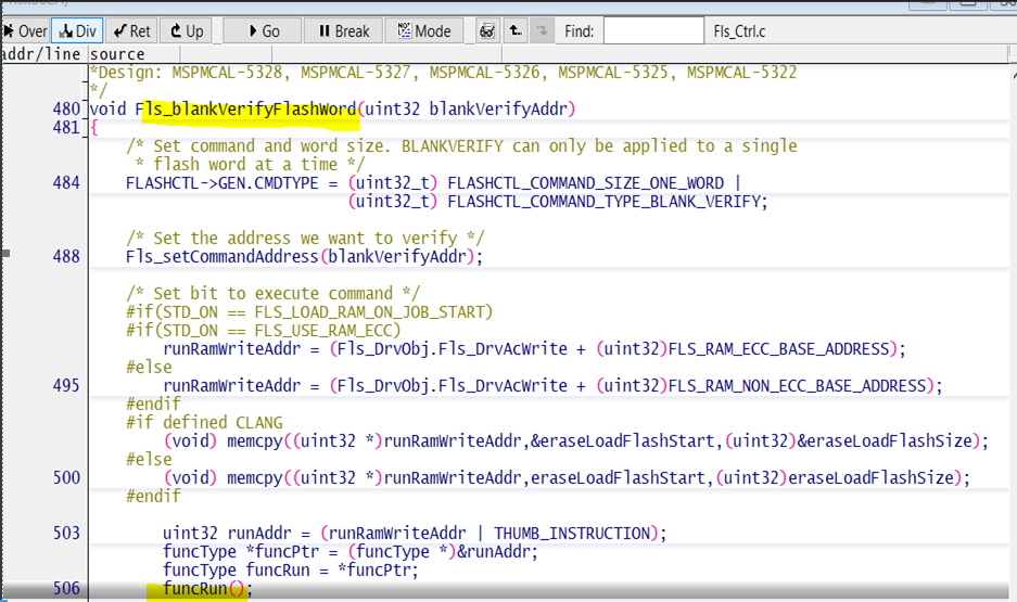

While performing Fee_Init() using latest MCAL package from TI. Below are the observations.
  • Fee module invokes Fls_blankVerifyFlashWord() as shown below
    • During the execution of funcRun(), it is observed that OS Exception is reported.

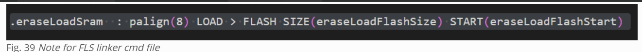

  • Rootcause Analysis:
    Fls user guide mentions to have linker command file(CLANG Compiler) as shown below
  • When Clang compiler is used for building Application, we have not observed Fee initialization issue, but when GHS compiler is used, the issue is observed.

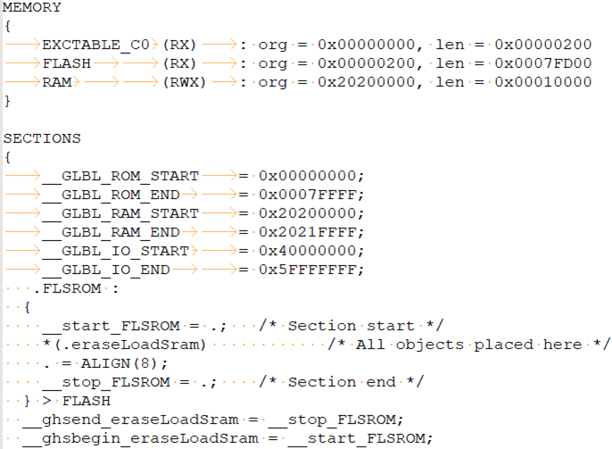

    Linker script for GHS compiler :
    • Generated .map

    Please add the below code into the suggested files as follows:
    In linker command file of GHS, add a section
        .eraseLoadSram align(16) : {
            __ghsbegin_eraseLoadSram = .;
            *(.eraseLoadSram)
            . = ALIGN(16);
            __ghsend_eraseLoadSram = .;
        } > FLASH
    In Fls_ac.h, add/check this section
    #elif  defined(__ghs__) || defined(GHS)
    /* GHS compiler: Use #pragma ghs section for section placement */
    #pragma ghs section text=".eraseLoadSram"
    void Fls_executeCommand(void);
    #pragma ghs section text=default
    In Fls_ac.c, add/check this section
    #if defined(__ghs__) || defined(GHS)
    /* GHS compiler: Use #pragma ghs section to place function in .eraseLoadSram */
    #endif
    In Fls_ctrl.c, add/check this section
    /* GHS compiler: Use linker-defined symbols for section info */
    /* These symbols should be defined in the linker script */
    extern uint32 __ghsbegin_eraseLoadSram[];
    extern uint32 __ghsend_eraseLoadSram[];
    #define eraseLoadFlashStart __ghsbegin_eraseLoadSram
    #define eraseLoadFlashSize ((uint32)((uint8*)__ghsend_eraseLoadSram - (uint8*)__ghsbegin_eraseLoadSram))

  • Expected functionality is achieved with below changes taken into build environment. Other two changes are checked and already are part of MCAL package.
    * In linker command file of GHS - GHS linker file updated and
    * In Fls_ac.c, add - MCAL package updated
