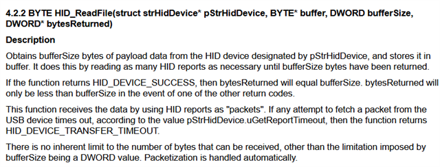

I'm using the HID datapipe, with the standard VID, and a PID supplied by TI.
The issue causes every other message to timeout.  I didn't notice for some time because my PC was retrying.
Once I noticed, I checked with Wireshark and saw good HID packets being sent each time.
I traced the problem to the function "USBHID_getBytesInUSBBuffer" in USBHid.c
