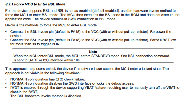

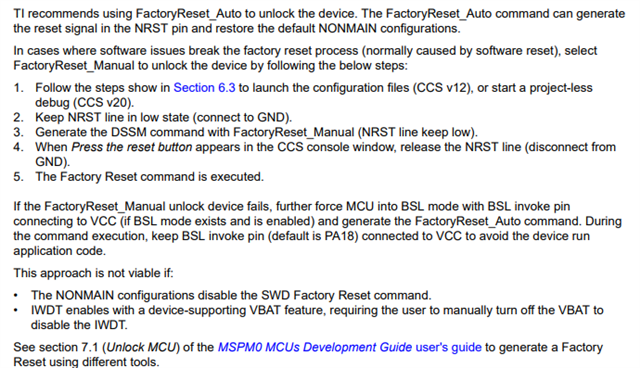

    To quickly recover, you can refer to below two methods:
    1. Force MCU to Enter BSL Mode
    2. Factory Reset
    You can refer to the documents:https://www.ti.com/jp/lit/ug/slaaeo4/slaaeo4.pdf
