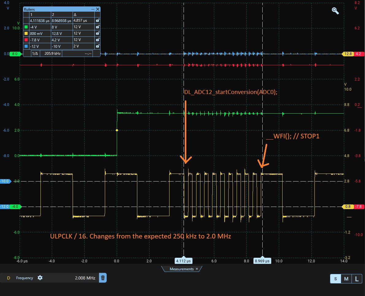

I'm testing on a MSPM0G3519 evaluation board. SYSOSC 4MHz . ADC CLK ULPCLK. CLK_OUT ULPCLK/16. Measuring internal temperature. The temperature reading works. I've disabled all the fast clock requests in SYSOSCCFG and in the ADC config. I'm getting the ULPCLK switching frequency. If I don't go into STOP1 then the frequency stays high for the whole conversion.
This is a problem for me because I want to keep a stable SYSOSC frequency.
The processor clocking does not seem to be operating as described. Appreciate you looking at my request.
Stephen

  • Hi Pengfei,
    Thanks for your feedback. I checked the settings and they are as you have suggested. BLOCKASYNCALL=1, USE4MHZSTOP=1, FREQ=1 which is 4 MHz.
    SYSOSCCFG:00010101 MCLKCFG:00401000 PMODECFG:00000000 SCR:00000004
    STOP1 Temp : 20 C
    The processor is running at 4MHz before the ADC conversion is started. This is confirmed by the CLK_OUT. The clock goes back to 4MHz during STOP1.
    If I don't go into STOP1 and loop waiting for the conversion to complete the clock remains at 32 MHz the entire conversion time, and only switches back to 4 MHz at the end. If I read "Common ADC Use Case" at the bottom of page 1132 of the reference guide, I see that if the trigger occurs during RUN, which is in my case, the conversion should run without changing SYSOSC frequency. I'm puzzled.
    Stephen

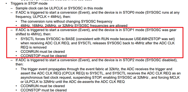

  • Hi Stephen,
    I see from the TRM Common ADC Use Cases chapter that the SYSOSC will be forced to BASE if MCU is awaked from STOP1 mode. I'm not sure could you please share your example which could reproduce the frequency switching sequence you mentioned, so that I could also test and analyze from my side?
  • Claude helped me isolate some test code. See attached. Compiles in IAR. Runs on the MSPm0G3519 Eval board. Connect a probe to PB28 to trigger and PA7 for the clock.
    #define USE_STOP1_WAIT  1 // set to 1 or 0 to enter STOP1 mode or not.
    I do note that the debugger can change the clock when connected and active.
    Let me know if I can help with more info.TEST_ADC.zip

  • Hi Stephen,
    As I checked internally, by design, the SYSOSC clock will always get enabled (if disabled) and switch to 32MHz whenever an ADC conversion request is received. This will happen even if BLOCKASYNCALL is 1.
    We plan to modify the corresponding description in Technical Reference Manual about SYSOSC frequency behavior during ADC conversion, and sorry for the inconvenience of it.
