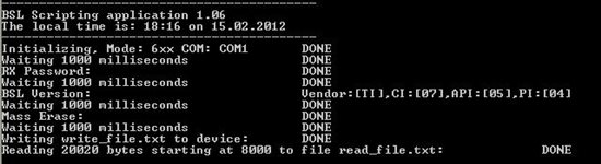

  • Dear Thomas,
    BSL command works after downloading UART BSL code of "MSP430F552x_TA_UART" custom bsl project(SLAA450)  in msp430f6636.
    i have tried following commands though BSL_Scripter.exe
    Code down loading in flash is also done successfully.
    so, after doing above exercise i came to following conclusion.
    1. Every msp430f6636 device has default BSL code for USB. so to use BSL through UART, customize code for UART has to be downloaded.
    Thanks for your kind help.
