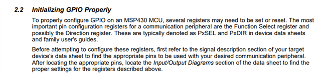

    I also have a question regarding pin multiplexing on the MSP430FR6007.
    I noticed that the same physical pins can be assigned to multiple peripheral functions, such as SPI and UART. For example, a pin may support both UCA2 SPI signals and UART TX/RX functions. Could you please explain how to determine which peripheral function is active? Specifically, how do the PSEL0 and PSEL1 register settings select between SPI, UART, GPIO, and other alternate functions?
    Additionally, since I am now seeing some response on the oscilloscope but not the expected SPI waveform, could you suggest what I should check next to verify that the SPI configuration is correct?
    I would appreciate any clarification on how the pin multiplexing mechanism works and any guidance on troubleshooting the SPI signal.

    Pin configuration is well covered in the pin diagram section of the data sheet.

  • ok  but i my question ,i noticed that the same physical pins can be assigned to multiple peripheral functions, such as SPI and UART. For example, a pin may support both UCA2 SPI signals and UART TX/RX functions. Could you please explain how to determine which peripheral function is active? Specifically, how do the PSEL0 and PSEL1 register settings select between SPI, UART, GPIO, and other alternate functions?
    e.g pin spi selection   psel0=0 , psel1=1 then what for uart ?

    with the same PSEL0 and PSEL1 settings.
    In this case, how can I determine which protocol is active on the pin? Will the pin function as SPI (SIMO) or UART (TXD)? Is the active function determined by the configuration of the UCA1CTLW0 register (SPI mode vs UART mode), or is there another mechanism involved?
    I would appreciate some clarification on how the MSP430 selects between SPI and UART functionality when multiple peripheral functions share the same pin.
    Thank you for your assistance.
    I also have one question regarding pin multiplexing. For example, in the datasheet, a pin may be listed as:
    UCA1SIMO / UCA1TXD
  • e.g pin spi selection   psel0=0 , psel1=1 then what for uart ?
    The pin doesn't know or care. Module configuration determines if it is UART or SPI.
