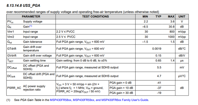

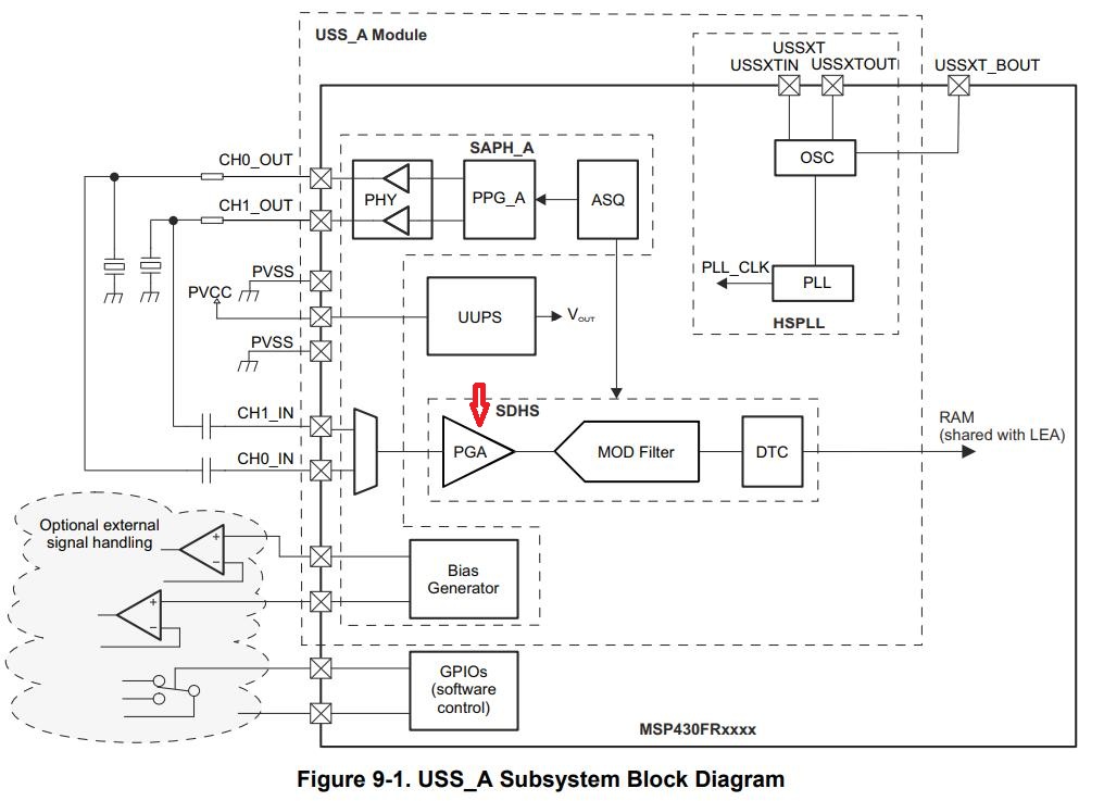

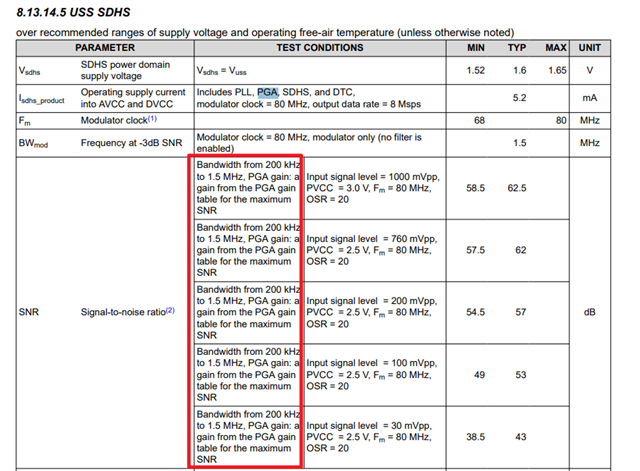

I would like to know the gain-bandwidth product, slew rate, and offset voltage of the PGA in the SDHS function block.

Hi Tommy,
Please refer to the chapter "8.13.14.8 USS_PGA" in the datasheet for the details of the PGA spec, and also you can refer to the "8.13.14.5 USS SDHS" for some info about the bandwidth as shown below.
