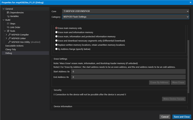

I am using  MSP430I2041 controller in my project: Name: Transducer
 I was storing application data in Information Memory, but the TLV data also got erased. To avoid this, I moved the data storage to Main Flash Memory.
However, the data in Main Flash gets erased whenever I reprogram the device. Could you please suggest the recommended way to store user data so that it is retained during firmware updates/reprogramming while also ensuring that TLV data is not affected?
Any guidance or recommended practices would be greatly appreciated.
