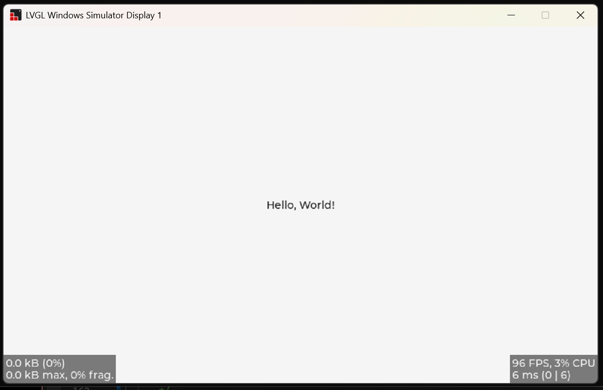

#1: Our first label
Add a global object just above main():
              lv_obj_t *MyLabel;
This creates a pointer to an LVGL object.
Now in main() just ahead of the while() loop add the following:
              MyLabel = lv_label_create(lv_scr_act());
    lv_label_set_text(MyLabel, "Hello, World!");
    lv_obj_align(MyLabel, LV_ALIGN_CENTER, 0,0);
This creates a new label, assigns it to MyLabel and initializes it to "Hello, World!"
It also aligns it to the center of the display.
Go ahead and compile and run it on your hardware.
(My screenshots are from my MSVS simulator - see below)

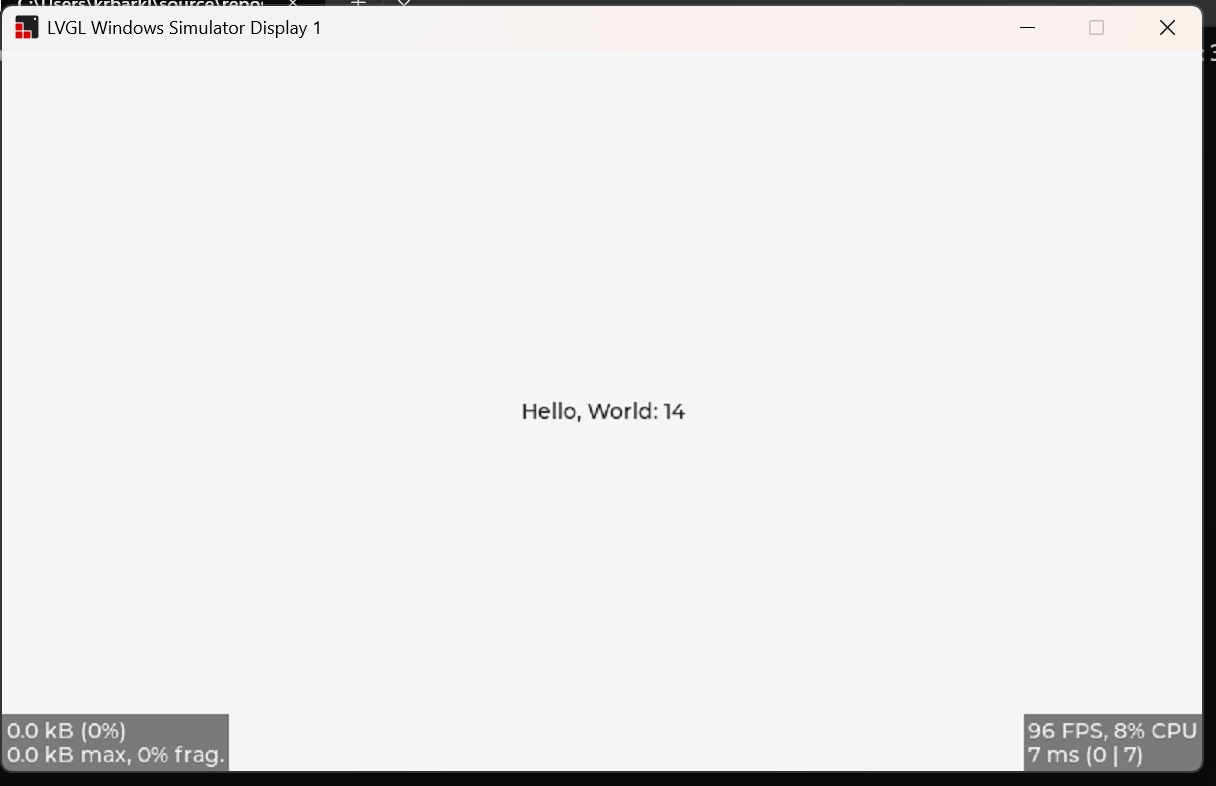

#2 Counter
Let us make a slight modification to create a live counter in our label.
Add this variable and function to the global area above main():
Int Counter = 0;
void UpdateCounterTimer(lv_timer_t* timer)
    lv_label_set_text_fmt(MyLabel, "Hello, World: %d", counter);
    counter++;
And add this function underneath the other MyLabel code:
lv_timer_create(UpdateCounterTimer, 1000, NULL);
Build and run.
This code adds a timer that will call UpdateCounterTimer() every 1000 ms.
[Note, at least on my launchpad, it updates much faster. The interrupt is probably being called faster than every 1 ms]
When UpdateCounterTImer() is called, it sets a new text label with the counter value.

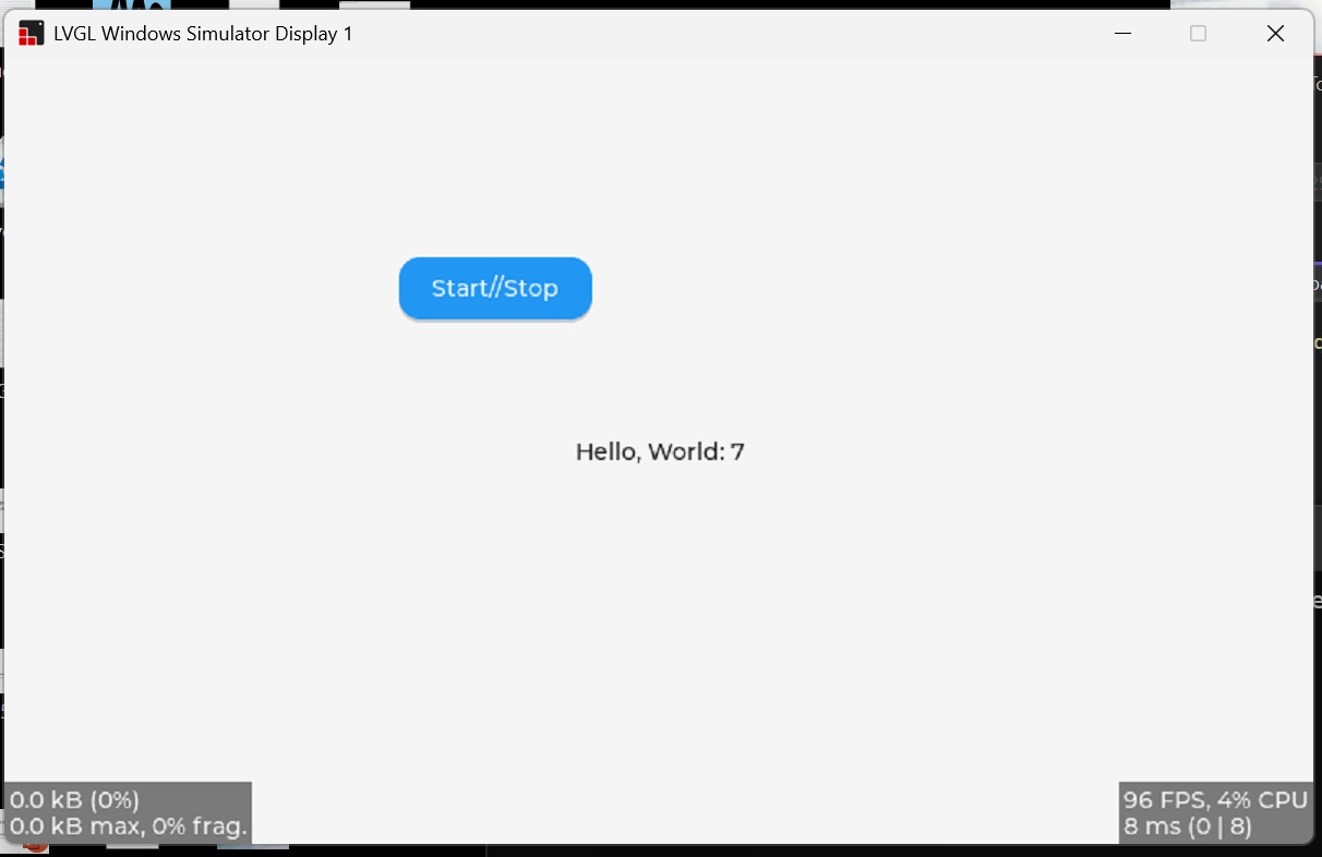

#3 Button
One final modification, let’s add a button.
In the global area, we need a button and Boolean to act as a flag:
lv_obj_t* Button;
volatile bool Flag = false;
And a function to handle our button event:
void Button_Event_Handler(lv_event_t* e)
    lv_event_code_t code = lv_event_get_code(e);
    if (code == LV_EVENT_CLICKED) {
        if (Flag == false)
            Flag = true;
        else
            Flag = false;
If we had more than one button we might need to add code to discriminate between buttons
Let us make a slight change in the UpdateCounterTimer() function by only updating the counter if the flag is false
    if (Flag == false)
        counter++;
Finally, let us add the button startup code to main():
Button = lv_btn_create(lv_scr_act());
lv_obj_add_event_cb(Button, Button_Event_Handler, LV_EVENT_ALL, NULL);
lv_obj_align(Button, LV_ALIGN_CENTER, -100, -100);
lv_obj_t* label;
label = lv_label_create(Button);
lv_label_set_text(label, "Start//Stop");
lv_obj_center(label);
This creates a button as a child of the main screen. (“lv_scr_act()”) It is aligned above and to the left of the original label.
We then create a label that is a child of the button, and add some text.
Compile and run. You should see something like this:
As you click the button you can start and stop the counter.
