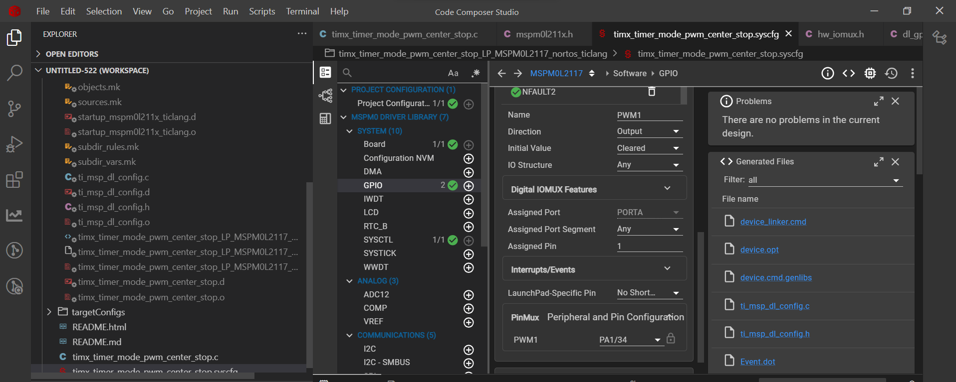

We are trying to interface the MSPM0L2117SRHBR with the motor driver DRV8242
We connect pin 2 (PA1) to IN1 of the motor driver.
But so far, we are unable to set PA1 to drive it. We are not even able to set that pin to high.
This is the current configuration on on the  syscfg tool.
We have discarded to be a PCBA problem so far so we suspect that there might be an issue with the libraries. According to the datasheet PINCM2 is set to address 0x40428004, but in our debugger (Segger JLink) IOMUX_PINCM[0] seems to correspond to that address.
Do you have any suggestions?
