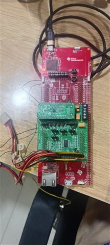

I have the following modules: DAC53608EVM, BOOSTXL-DAC-PORT & MSP-EXP432E401Y Launchpad.
My aim is to generate a sine/distorted sine wave using DAC outputs. For the same I tried 2 methods:
1. Using TI GUI , there is a scripting feature where I wrote a block code first to write the 8 DAC outputs, however I received a prompt that for using scripting feature "SharedArrayBuffer" needed to be enabled in the Chrome browser. I tried although, I found in newer versions of chrome this feature is discarded, thus I am stuck with the same.
2. The other method I tried was using Code Composer Studio (CCS) to write the DAC outputs , however, I2C is seem to be non communicating. I checked through oscilloscope on the SCL & SDA pins, the pins are pulled high at 3.3V but no pulses, thus I am unable to write the DAC outputs.
Kindly help me with either way, so that I can program DAC outputs to generate a Sine or distorted Sine wave. Also, if there is a way to upload a csv or hex file to achieve the same, then let me know.
