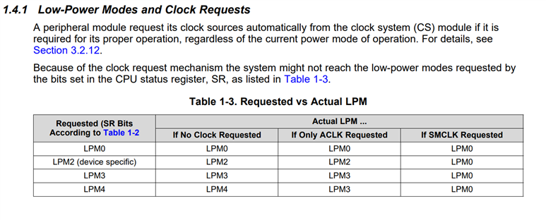

We observed an issue related to LM4 mode current consumption on the MSP430 device.
According to the datasheet, the expected current consumption in LM4 mode is approximately 1.5 µA. However, in our setup, the measured current consumption is around 0.114mA using Energy Trace.
Current observations:
  • Device enters LM4 mode successfully
  • UART and interrupt configurations are enabled in the application
  • Measured current is stable around 114 µA using Energy Trace
  • Measurement performed on MSP-EXP430FR2433 Development board
Any guidance or reference low-power examples would be helpful.
  • If a module requires SMCLK then the clock request system will keep that clock running even in when LPM4 is set. Resulting in higher operating current. Well covered in the guide.
  • Hi Keshavamurthy,
    As David mentioned above. Please refer to this user's guide.MSP430FR4xx and MSP430FR2xx family user's guide (Rev. I)

  • We are using the MSP430FR2433 LaunchPad and measuring the target current using the Energy Trace.
    As per the MSP430FR2433 datasheet, the typical current consumption in LPM4 is around 0.65 µA. However, in our application we are measuring approximately 56–66 µA.
    Our application has the following configuration:
    • UART (eUSCI_A0) configured using SMCLK.
    • Three GPIOs configured as inputs with pull-up resistors.
    • 3 GPIO interrupts enabled on the falling edge.
    • The MCU enters LPM4 after initialization.
    • On a GPIO interrupt, the MCU wakes up, transmits a status message over UART, and returns to LPM4.
    We are measuring the current in Energy Trace.
    Could you please advise:
    1. Is 56–66 µA expected with this configuration?
    2. Does keeping the UART configured from SMCLK prevent the device from achieving the datasheet LPM4 current?
    Any recommendations or best practices for achieving the lowest possible current in this use case would be greatly appreciated.
    Thank you.
  • The UART will keep SMCLK, and whatever sources it, running while it is busy. When it isn't busy, the clock will shut off.
    Another thing to check is the recommended configuration for unused pins.
