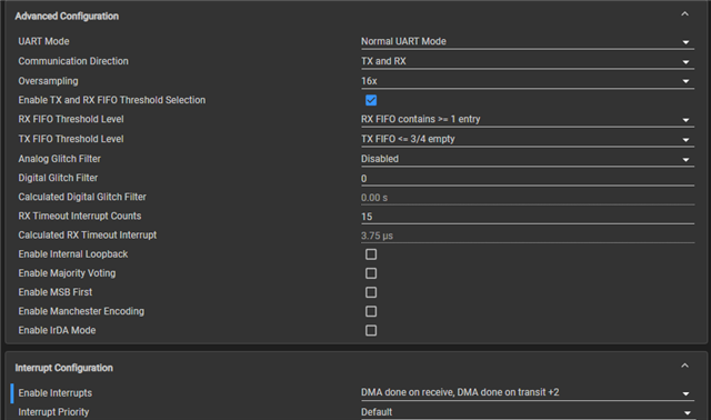

    I configured the DMA transfer size to 64 bytes, while the actual RX packet size is currently 5 bytes. However, when I read the remaining DMA transfer count in the DL_UART_INTERRUPT_RX_TIMEOUT_ERROR interrupt using the DL_DMA_getTransferSize(DMA0, DMA0_CH1_CHAN_ID) API, the returned value is 0 instead of 5. I also checked the transfer count in the DL_UART_IIDX_DMA_DONE_RX interrupt and observed the same result, with the count still reported as 0.
    I am attaching my SysConfig configuration for UART and DMA for your reference.
    Please note that I am able to receive a fixed number of bytes using DMA. However, my application receives multiple commands with variable lengths, and I need a reliable way to determine the actual number of bytes received. I would appreciate a quick resolution, as this is an urgent issue.

    Thanks for the update and the SysConfig screenshot. The new approach of using UART RX interrupt as the DMA RX trigger and RX TIMEOUT as the frame boundary is the right direction.
    A few things to check:
    1. In single-transfer DMA mode, the DMA transfer size of 64 means 64 UART RX trigger events are required before the DMA block is complete. If the actual received packet is 5 bytes, the expected remaining count would be 59, not 5. The received length would then be 64 - 59 = 5 bytes.
    2. Please read the DMA transfer size before disabling the DMA channel. In the code patch, the DMA channel is disabled before calling DL_DMA_getTransferSize(). Disabling the DMA channel may affect the live channel state, so the count should be captured first.
    3. The screenshot shows “Configure Transfer Size” unchecked. If SysConfig is not setting the transfer size, please make sure the application calls DL_DMA_setTransferSize(DMA0, DMA0_CH1_CHAN_ID, 64) every time before enabling the DMA channel.
    4. Please also confirm that the RX DMA destination address increments after each transfer. For UART RX DMA, the source address should remain unchanged at UART RXDATA, but the destination address must increment so each received byte is stored into the next buffer location.
    As an alternative to using DL_DMA_getTransferSize(), we recommend reading the current DMA destination address at RX TIMEOUT and calculating the received length as:
    rxLen = current DMA destination address - start address of RX buffer
    This avoids ambiguity around reading the transfer-size register after the DMA channel is disabled or after DMA completion.

  • Hi Rajeshwary,
    Thanks for the additional data. The destination address values are very helpful.
    With the UART RX DMA trigger selected, the destination address moved from 0x30007FCD to 0x3000800D, which is a 64-byte difference. This indicates that the DMA channel completed the full 64-byte receive window, not a 5-byte packet. Therefore, the timeout is not being captured at the 5-byte frame boundary in that setup.
    One important point from the TRM is that RX TIMEOUT is asserted only when the receive FIFO is not empty and no further data is received for the timeout period. If the RX FIFO threshold is configured as RX FIFO contains >= 1 entry, the DMA can drain each byte immediately as it arrives. In that case, the FIFO may be empty at the end of the frame, so RX TIMEOUT is not a reliable frame-boundary indicator.
    Please try setting the RX FIFO threshold higher, for example RX FIFO contains >= 1/2 full, and keep the DMA RX trigger as UART RX interrupt. With this setup, DMA handles the bulk data, and RX TIMEOUT is used to handle the residual bytes left in the FIFO. In the RX TIMEOUT ISR, disable the UART RX DMA trigger, read the current DMA destination address to determine how many bytes DMA already moved, then manually drain the remaining bytes from the UART RX FIFO into the buffer. The packet length is:
    rxLen = (current DMA destination address - RX buffer start address) + residual FIFO bytes drained by CPU
    When the DMA trigger is changed to UART RX TIMEOUT, the observed length of 4 bytes is consistent with the timeout event only draining the current FIFO contents. That mode is not recommended for receiving arbitrary variable-length packets larger than the UART FIFO depth.
    Also, I recommend using the DMA destination address plus residual FIFO drain count instead.
