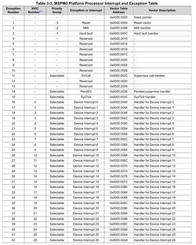

  • Hi Vinay,
    Are you able to hold an active debug session after the bootloader attempts to jump to your target application?
    If so, can you check the xPSR and share the exception value:
    The following table can be used to decode it:
    If it's an NMI (0x2), please also check the SYSCTL NMIIIDX register and compare with the included table:
    If the above is not the case, are you able to recreate the issue on firmware you would be able to share with me so I can debug on my side?
    Brian

  • Hi Vinay,
    Looking back over the thread, I see that you modified the SRAM length to 0x6E00. 0x6E00 places the initial stack pointer at 0x20208100, which is 256 bytes beyond physical SRAM. Change it to 0x6B00 exactly.
    To catch the fault in the debugger, implement a HardFault_Handler in your custom application, then set a breakpoint inside it. The screenshots show the xPSR captured while still inside the BSL before the application jump, which will always show a clean state.
    Brian

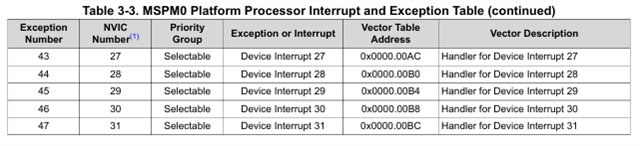

    Issue 2: Your application's interrupt handlers never execute
    What's happening:
    Your application uses I2C slave mode, ADC conversions, and timers — all of which generate hardware interrupts. However, these interrupts are currently being routed to the bootloader's handlers, not your application's.
    When the CPU starts, the Vector Table Offset Register (SCB->VTOR) points to address 0x0 — the bootloader's interrupt vector table. Your application's startup code (startup_mspm0g350x_ticlang.c:181-187) never updates VTOR to point to your application's vectors:
    void Reset_Handler(void) {
        __asm("b _c_int00");  // jumps to C init, but VTOR still points to bootloader
    Your linker script reserves a .vtable section in RAM for relocating the interrupt vectors, but nothing ever copies the vectors there or updates VTOR. The map file confirms the .vtable section doesn't exist in the final binary.
    Result: When your I2C hardware fires an interrupt, the CPU jumps to the bootloader's I2C0_IRQHandler (which just loops forever in Default_Handler), not your application's handler. Your i2cSlaveServices() and adc_services() never see the interrupts they're waiting for.
    Simple apps work because they don't use peripheral interrupts — just polled GPIO.
