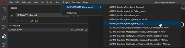

    Can you try a factory reset of the device?
    1. start projectless debug session from the .ccxml in the targetConfigs folder (right click the file)
    2. select the CORTEX_M0P from the Threads section of the debug view (Left click the core to highlight)
    3. Run the MSPM0_Mailbox_FactoryReset_Auto command from the scripts tab

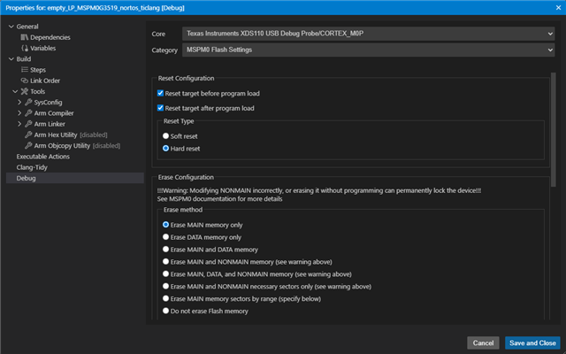

    Additionally, are you modifying NONMAIN memory in your application?
    • If so, you will need to change the project settings because the default is for only main memory to be erased:
      • Go to Properties->Debug->Category: MSPM0 Flash Settings-> Erase Configuration
