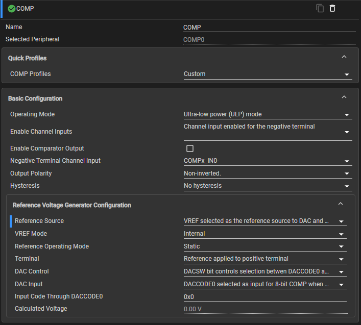

Task: Evaluate a simple switch debouncing circuit as discussed in SCEA094 with MSPM0L2228's comparator module.

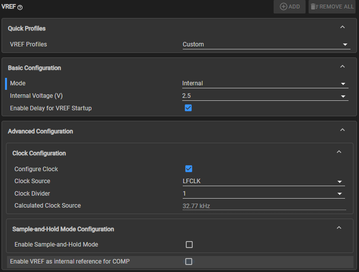

Issue: While trying to use the MSPM0L2228 VREF and COMP module, I am not able to get the comparator to trigger at my configured threshold voltage of 1.5 volts. Instead it triggers around 20 mVolts.
Test setup: Using a potentiometer to vary the voltage entering the COMP0_IN0- expecting to see LED toggle around 1.5 volts.
Below are my SysConfig settings for VREF and COMP:
Code snippets:
#include "ti_msp_dl_config.h"
#include  <stdio.h>
 * DAC8 Reference Voltage in mV
 *  Adjust this value according to the external VREF voltage.
#define COMP_INST_REF_VOLTAGE_mV (2500)
 * DAC8 static output voltage in mV.
 *  Adjust output as needed.
#define COMP_INST_DAC8_OUTPUT_VOLTAGE_mV (1500)
volatile static uint32_t onCount = 0, offCount = 0;
int main(void)
    uint32_t dacValue;
    SYSCFG_DL_init();
     * Set output voltage:
     *  DAC value (8-bits) = DesiredOutputVoltage x 255
     *                              ReferenceVoltage
    dacValue =
        (COMP_INST_DAC8_OUTPUT_VOLTAGE_mV * 255) / COMP_INST_REF_VOLTAGE_mV;
    DL_COMP_setDACCode0(COMP_INST, dacValue);
    DL_COMP_enable(COMP_INST);
    NVIC_EnableIRQ(COMP_INST_INT_IRQN);
    /* Calling WFI after calling DL_SYSCTL_enableSleepOnExit will result in
     * only ISR code to be executed. This is done to showcase the device's
     * low power consumption when sleeping.
    //DL_SYSCTL_enableSleepOnExit();
    while (1) {
        //__WFI();
        // Add a busy wait so the CPU stays in RUN mode
        for(volatile int i=0; i<10000000; i++);
        uint32_t status = DL_VREF_getStatus(VREF);
        printf("Status = %d | OnCount = %d | OffCount = %d\n", status, onCount, offCount);
void GROUP1_IRQHandler(void)
    switch (DL_COMP_getPendingInterrupt(COMP_INST)) {
        case DL_COMP_IIDX_OUTPUT_EDGE:
            DL_GPIO_clearPins(GPIO_LEDS_PORT, GPIO_LEDS_USER_LED_1_PIN);
            offCount++;
            break;
        case DL_COMP_IIDX_OUTPUT_EDGE_INV:
            DL_GPIO_setPins(GPIO_LEDS_PORT, GPIO_LEDS_USER_LED_1_PIN);
            onCount++;
            break;
        default:
            break;
Questions:
  1. Whenever I select "Enable VREF as internal reference for COMP", the project fails to build. Why?

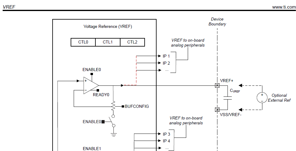

  2. Is there a way to test the VREF voltage through a pin or through the onboard ADC12?
Any guidance on the matter would be appreciated.
  • Hi ***,
    1. Can you share the .syscfg and .c files here? i want to replicate the issue from my end and see if it may be a misconfiguration. Also, what is the error that shows?
    2. The VREF can be monitored using an internal ADC channel (A0_28) which will need to be configured in the application code due to a bug that doesn't allow it to be configured in SYSCONFIG.
    Diego Abad
