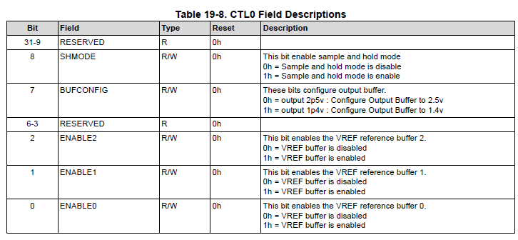

I am having trouble enabling the VREF for COMP module.
Can someone help clarify the fields: ENABLE0 Vs ENABLE1 Vs. ENABLE2?
    The Enable bits can be described as follows:
    • ENABLE0 - Enables the VREF module itself
    • ENABLE1 - Enables VREF output to Comparator
    • ENABLE2 - Enables VREF output to ADC
    The following is a capture from the hw_vref.h source file in the SDK:

    The available bits for the VREF CTL0 register are device dependent. In the case of MSPM0L2228, CTRL0[0] enables the external cap based VREF for  the ADC and COMP as well as the internal cap-less VREF for ADC. CTRL0[1] enabled the internal cap-less VREF for COMP.
    Sorry for the confusion the TRM descriptions may have caused. This has been reported and changes to our documentation and SDK will be made to better reflect this.

    For this device, Enable2 should be a reserved bit and should not show up in the register view. To see all bitfields, reserved and defined, you can connect to the CORTEX_M0P with the debugger and open the memory viewer:
    Our SDK currently gates this device from enabling the internal VREF to the COMP, but I am still waiting on clarity as to why this is:
    In the VREF module, checking the box that enables the internal VREF to the COMP generates a call to the above API. This would lead to an error with the ti_msp_dl_config.c file explaining why your initial project would not build properly.
    Brian
  •  , does the TRM documented ENABLE2 is reserved? Or is that the source of confusion?
    ENABLE2 is not reserved in the TRM, but it should not be defined for this device. There are internal teaks discussing how this should be handled going forward, but I cannot currently provide a timeline for when it will be clarified. I'm sorry for the confusion this has caused.
