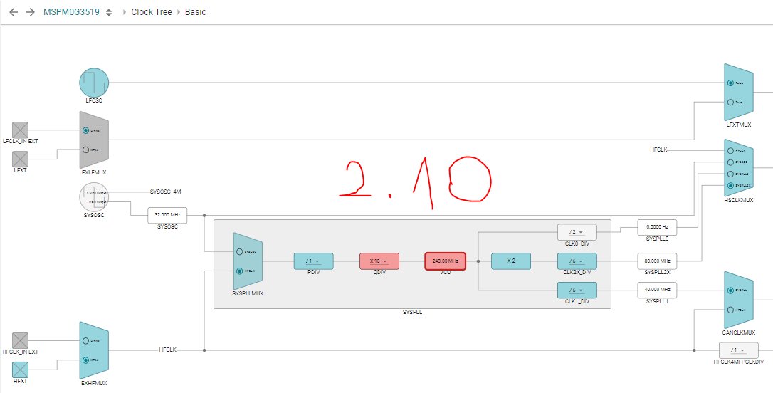

Hello ,

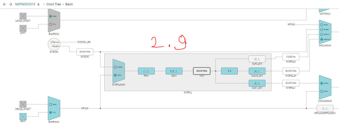

I am using MSPM0G3519 MCU and MSPM0 SDK. I have 24 MHz crystal on my board. I cannot set VCO to more than 160 MHz with MSPM0 SDK 2.10 and after. I am able to set with MSPM0 SDK 2.9.
I checked datasheet. fVCO max is 400 MHz.
How do I solve this problem?
2.9
2.10

    Thanks for your support. I don't want workarounds. I think this problem should be fixed on the root. I actually found the problem root and fixed on my machine. But it should be fixed on MSPM0 SDK releases.
    At the datasheet of MSPM0G3519 on Section 7.9.3 "System Phase Lock Loop (SYSPLL)" it clearly says f_VCO max is 400 MHz.
    After MSPM0 SDK 2.10 VCO max is reduced to 160 Mhz.
      SDK version    SYSCTLMSPM0.syscfg.js    clockTree/multiplier.js
      2.04.00.06     400 MHz                  400 MHz
      2.05.01.00     400 MHz                  400 MHz
      2.09.00.01     400 MHz                  400 MHz
      2.10.00.04     160 MHz  <-- regression  160 MHz  <-- regression
      2.11.00.07     160 MHz                  160 MHz
